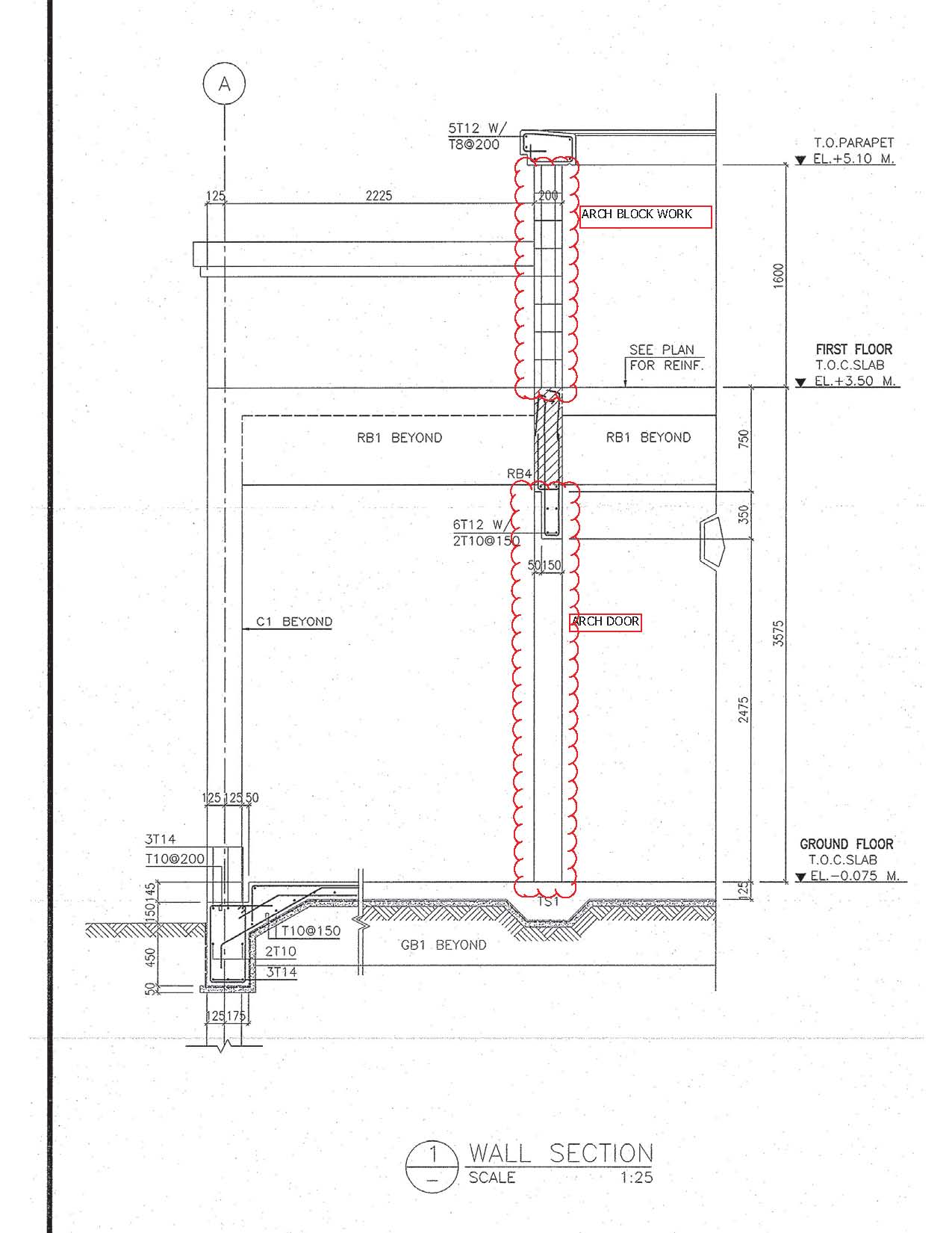

I have modeled my structural elements but i need to show some arch feachers in sections as per our office requirements so what is best practice? how to show arch block work or door/windows in our structural sections? sketch is attached as an example.

Simply edit the section using 2D elements like edit cut profile, filled regions, linework and detail elements.

@hub how about if we move the sections location latter or design changed do we need to update manually?...........is this not better to link arch'l model to struc'l & control with VG.

You should always be linking the models but that is not what you are asking and your section doesn't tell us what you want.   If you just want the architectural door to show up in that opening then turning on the linked model doors would probably do the trick.

@HUb i have shown in image above that i need to show arch'l door & some block work in parapet wall. any way ur reply has cleared my confusion & i think linking arch'l model could be a good option.
