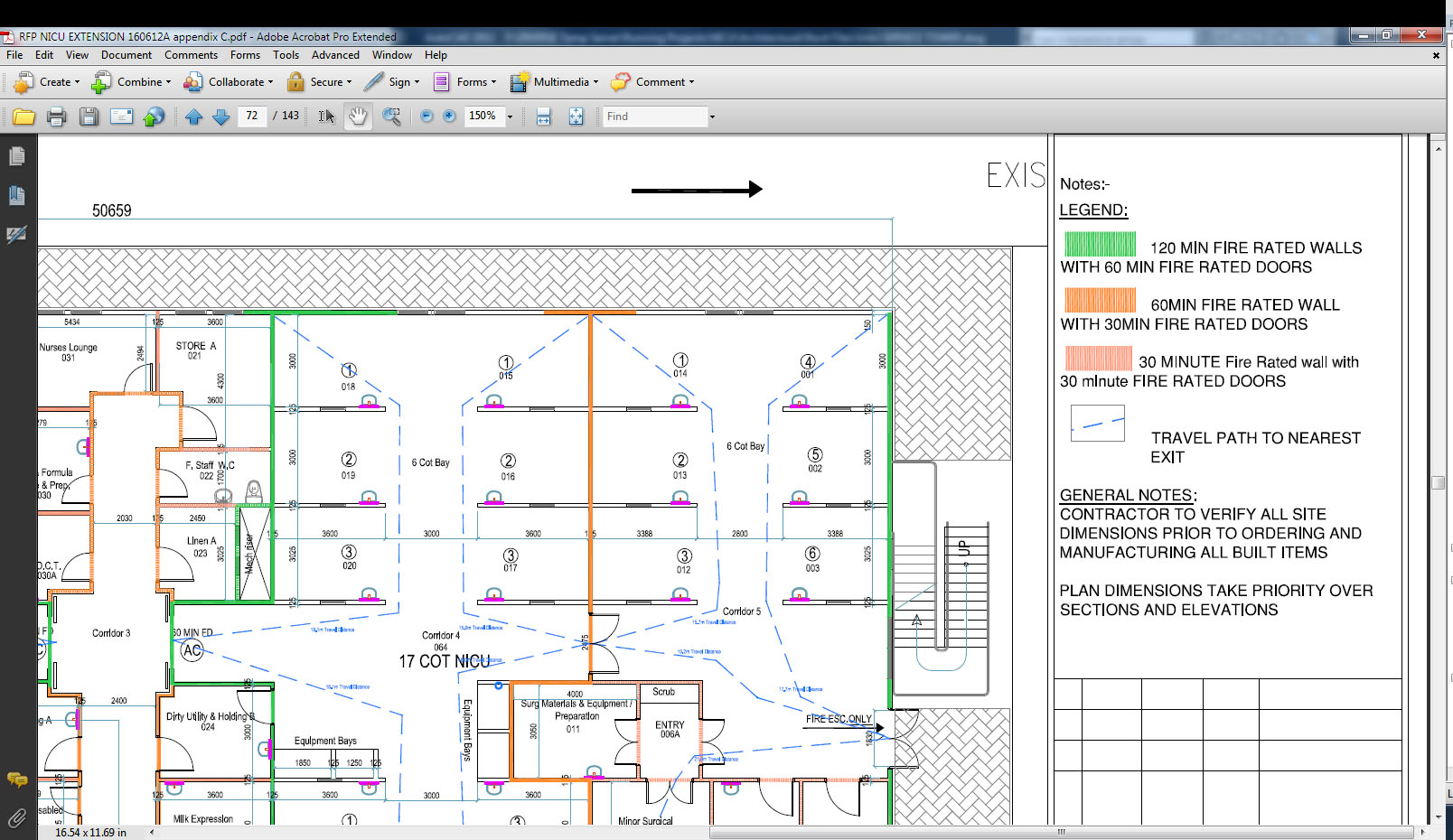

Is there somehow anyway to make a color legend for lines?. I mean I am making thick colored lines and i want a legend that refers to each line's color .
Please see the attached picture. i want something like it

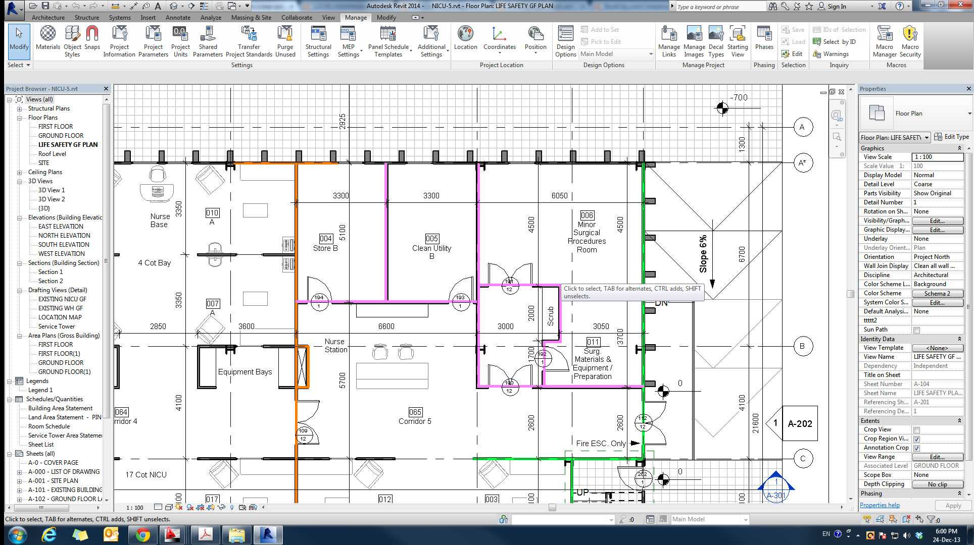

actually , the first picture is a pdf file that i received . and i have to do it on revit, and what i've done is making new line-styles. see the attached pic

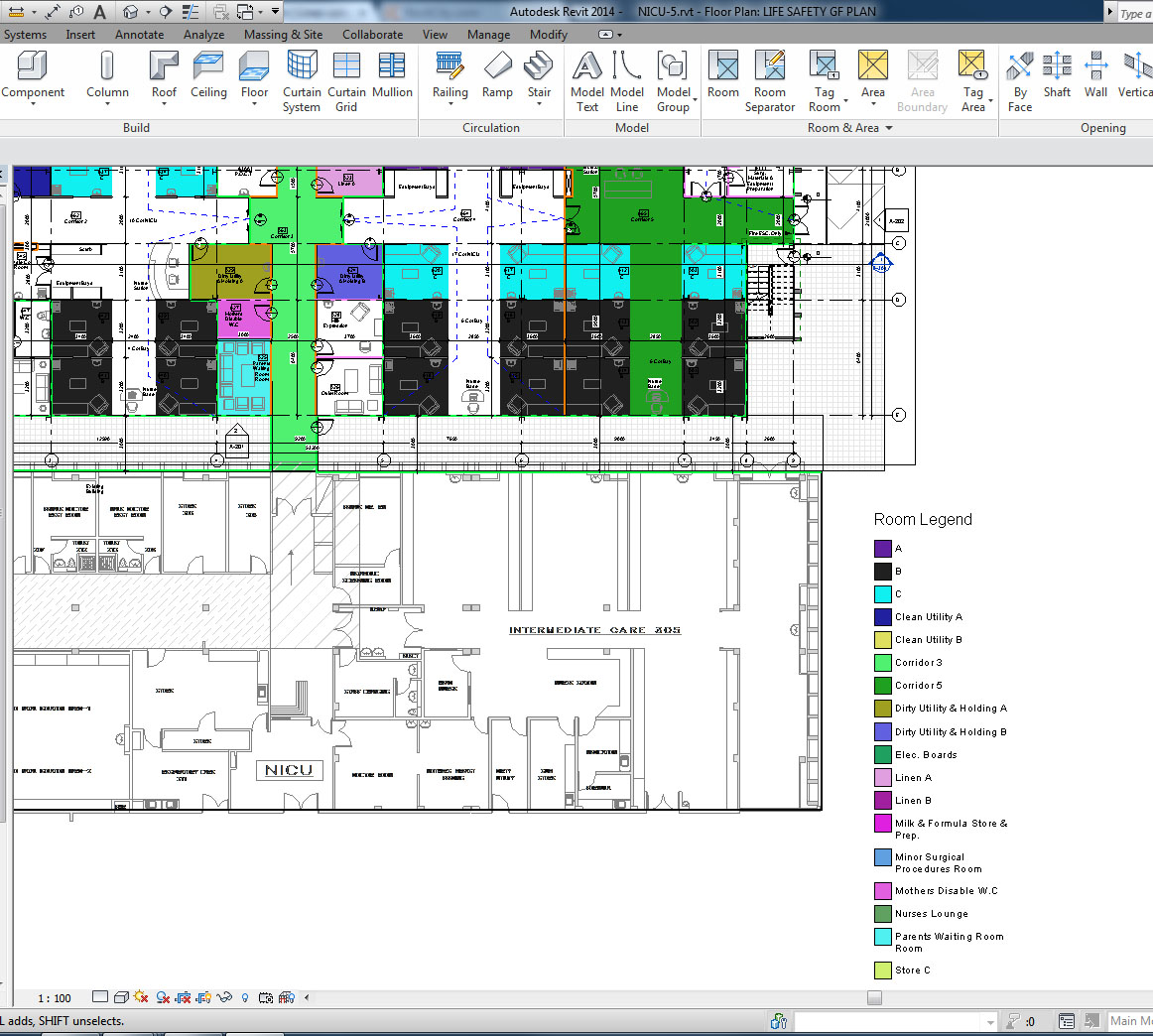

I know this . but my question was is it possible  to have an auto color legend like the rooms legend ((Look at the attachement))??????

You are not doing an area or room legend, are you?  Revit has those two only.  All other legends, you must create.
Please read this topic in your HELP:  Legend Views
