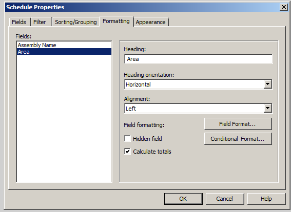

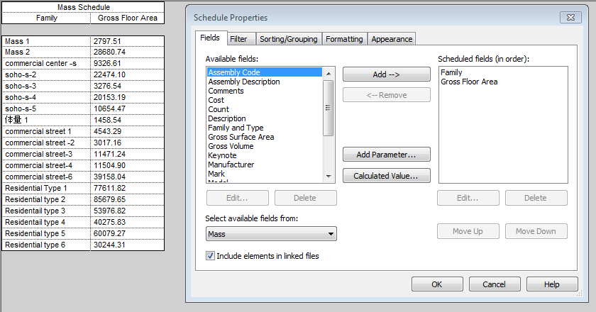

so after playing with all the functions for a bit, i noticed that you can include things from linked models, however i cant seem to do a few things.
Get the grand total for the whole model, i made 2 schedules, 1 was just a floor shedule, that included an area for each floor  of each link, but cant get a grand total. then made a gross floor area shedule which gives me the total per link, but still cant get the grand total for all the links together. I tried doing research if im supose to add a calculated value formula, but i cant seem to figure that out.
So in the fields box, am i supose to add other parametes that will calculate totals?
I have attached a screen shot, so if you see a mistake please correct me.
And this is a long shot, but is it possible to create schedules in my master model for each individual link? such as floor area per building, Cost, Count, etc? without doing it individually in each link? is that possible?
Thank you for your help.

If the areas of there, then you should be able to total.
