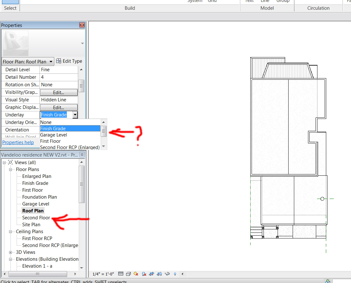

I want to underlay my roof plan with the floor below to ghost in the walls under the roof.
but the plan choice is not even on the list of possible underlays. (see screen shot) also it totally is showing one of the RCP plans in the choices list. I tried making a copy of the second floor but it too wont show on the roof plans properties. I can make the first floor show, but that doesnt help.
does anyone know whats up with that?

on your screenshot,
my guess is that the Second Floor Plan is just a copy of a plan of a certain level.
"but the plan choice is not even on the list of possible underlays." - underlay only lists levels (level name) not plan (plan name), unless your plan and level has the same name.

That was it. thanks! Keeping your levels and plan views clean is a good lesson.
