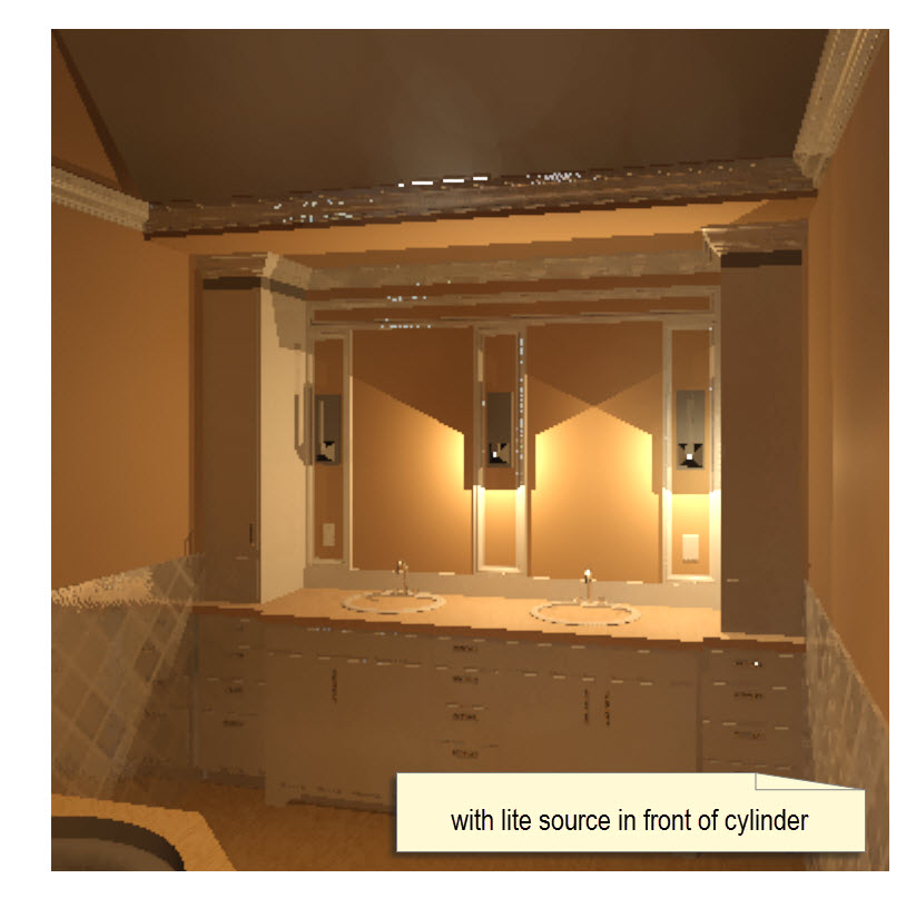

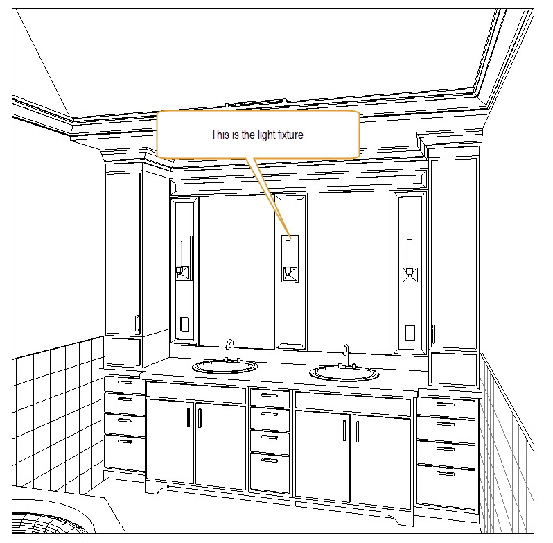

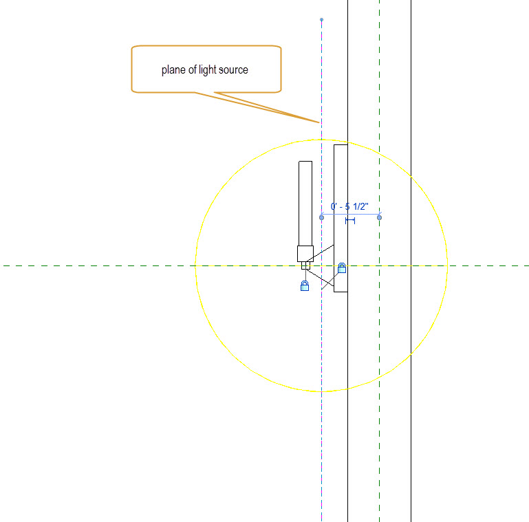

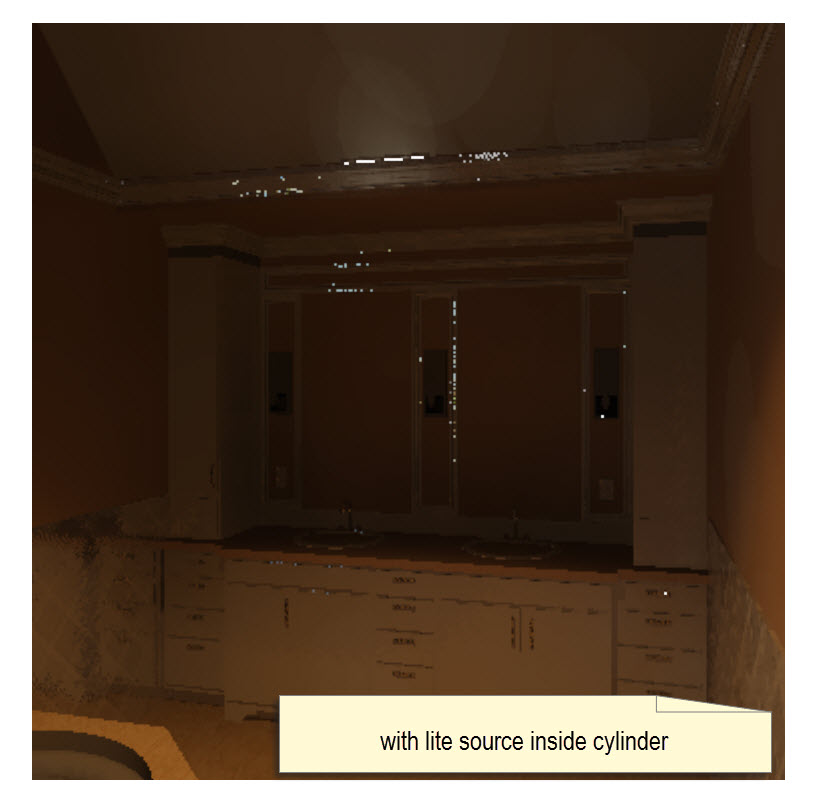

Is there a setting to make a light fixture component transparent to light?   I have had this problem with even stock light fixtures:  light does not emit from the fixture unless one makes the light source outside of the fixture.

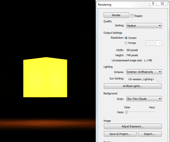

even when I set self-illuminance to a 10,000 luminance, it doesn't appear to iluminate or glow. http://screencast.com/t/oVadd8WOU5   Should "self-illuminance" result in an illuminated appearance?
