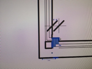

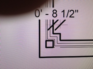

Hello,
I am trying to create a corner pilaster and have finally been able to get the walls together, but I need to move one of them over 1/2" and it dissapears/gets shorter (see attached).  How can I move this over without it doing this?
Thank you!
Wed, Dec 11, 2013 at 7:30:51 AM | Wall Disappears When Moved?
Short walls have always been a problem in Revit.  Read this thread: http://www.revitcity.com/forums.php?action=viewthread&thread_id=30654
