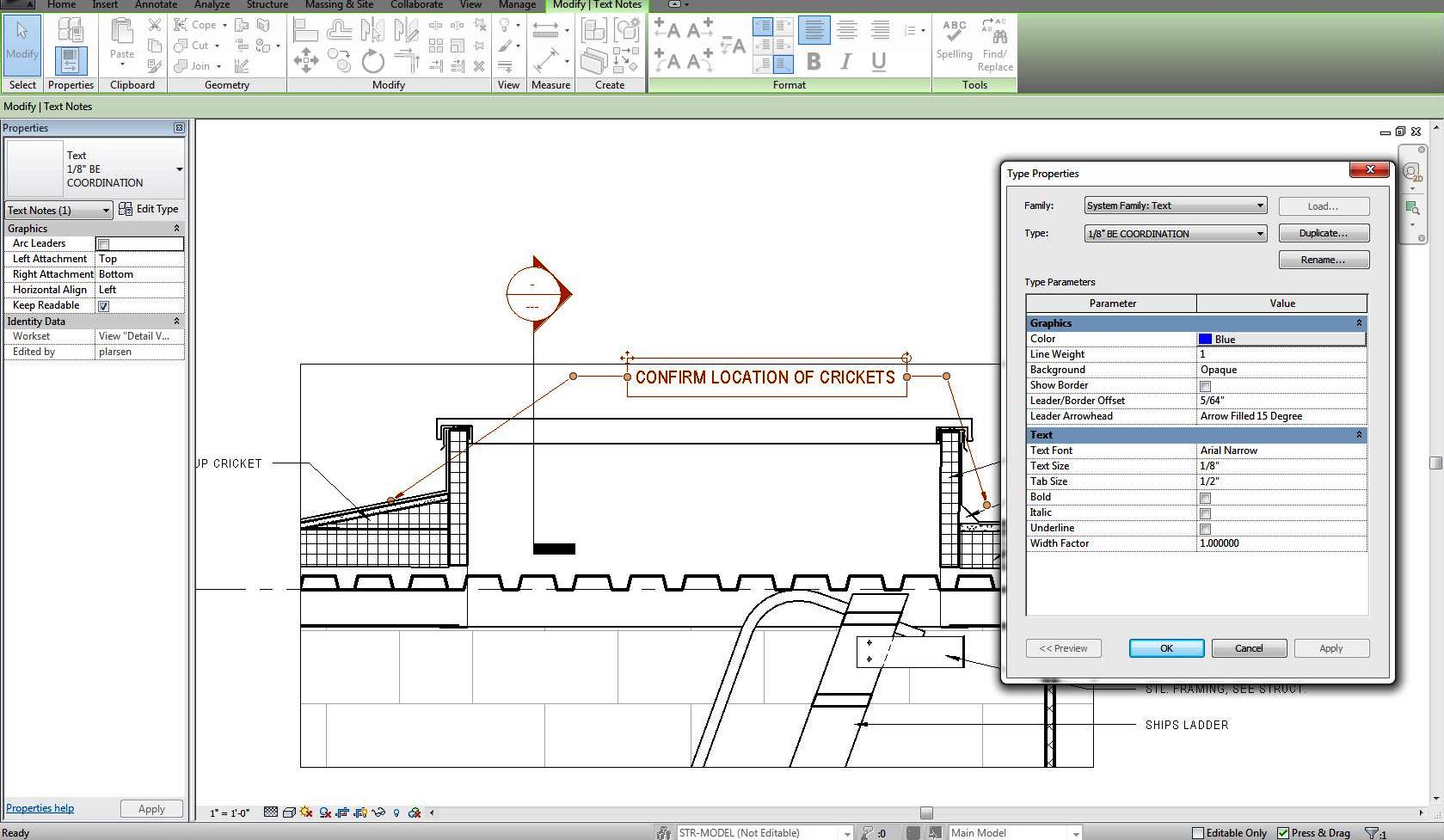

I'm using Revit 2012 and after a fresh reinstall on a new hard drive, all things that are supposed to be blue are showing up red.  See screenshot - that text has always shown up blue, and you can see the properties box for that text type is blue.  The section indicators are usually blue, too, and I haven't done any revisions to graphics settings.
Any thoughts on how to get blue stuff to show up blue?

This was found to be a windows update problem.  See this thread http://www.revitcity.com/forums.php?action=viewthread&thread_id=29623
