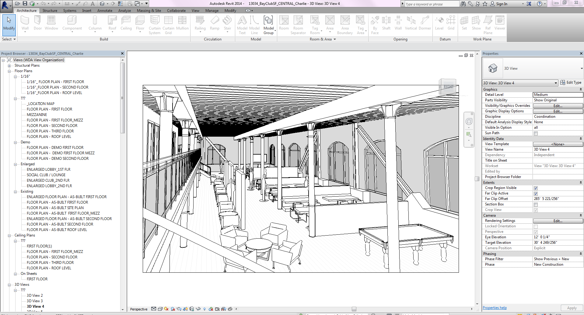

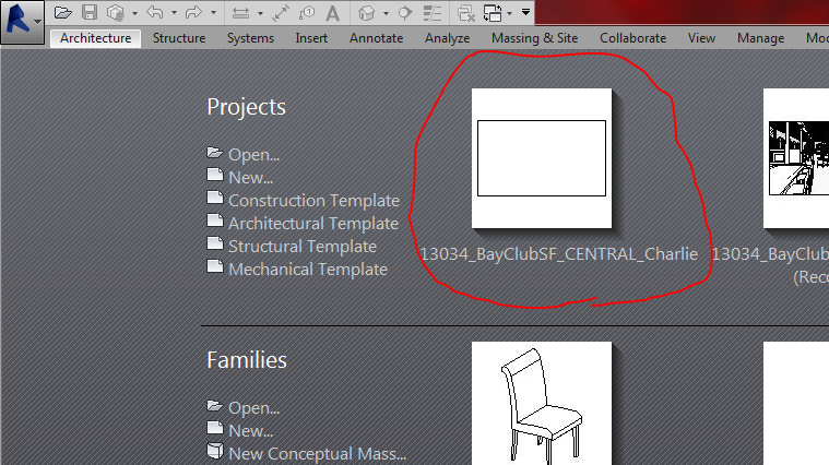

Interestingly, when I go to open Revit the preview thumbnail of the camera view also shows as blank (see attached #1), but when I open the project all the model elements appear as normal (see attached #2). Anyone else run into this before???

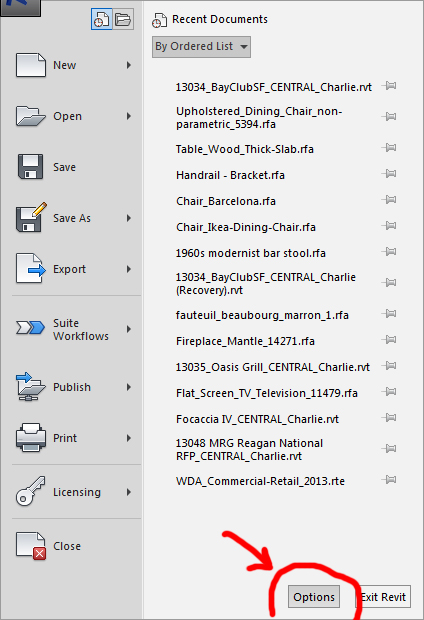

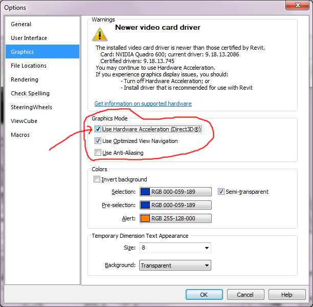

UPDATE: problem solved! I tried exporting an image from a different machine and was finally successful. The difference was that the other machine had hardware acceleration turned on, and my machine had it turned off. I turned on the hardware acceleration on my machine and could suddenly export images from 3D views again. Not sure why that matters, but it did.
For those of you unfamiliar with how to enable or disable hardware acceleration, see the attached two images.
