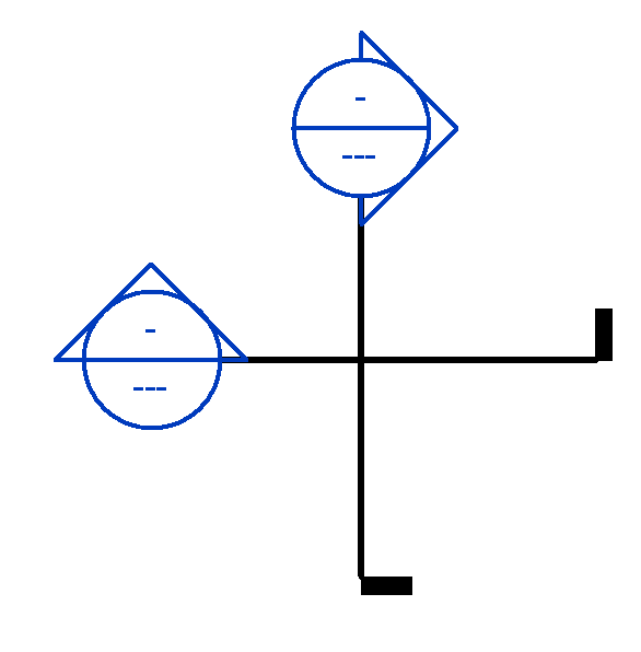

Im not new to Revit but Im new to the forum here and wanted to ask some questions.
I am working with an existing template and using the section marker. When I import it vertically, it is fine (the lines and text is fine).  When I rotate it or import it horizontally, the line inside the bubble rotates as well (but the text doesn't).  This causes the line inside to be right through the text  Any one know how I can edit those properties so the line inside the section bubble doesn't rotate?
Also, I want the inside of the bubble to be opaque so when placed within a ceiling plan, it shows over the ceiling hatch.
I appreciate any help you all can offer!

The standard section markers should look like the attached.  If they don't then you are using a custom marker that may not be bult correctly.
