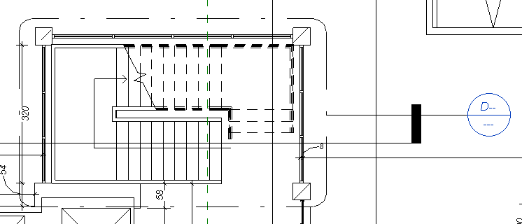

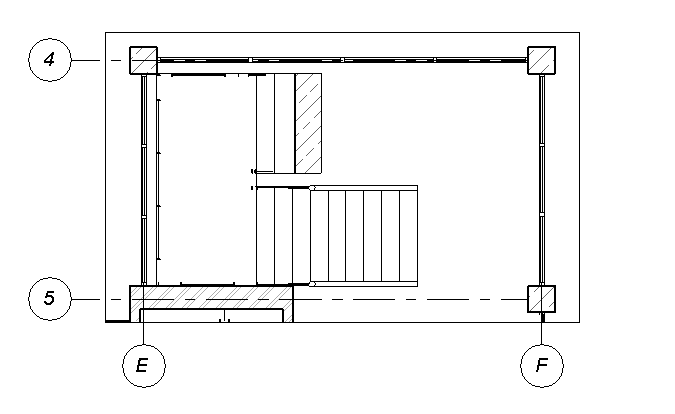

I want to creat a detail plan view in large scale from stairs to magnify details, but as u see in the screenshots when I open detail view the stairs dash line up from the cut plane would be disappeared, and the railing would cut from balusters.
how can I fix this problem? because I need to number all the treads in magnification plan.

Change the call-out to a floor plan instead of detail and see what happens.
