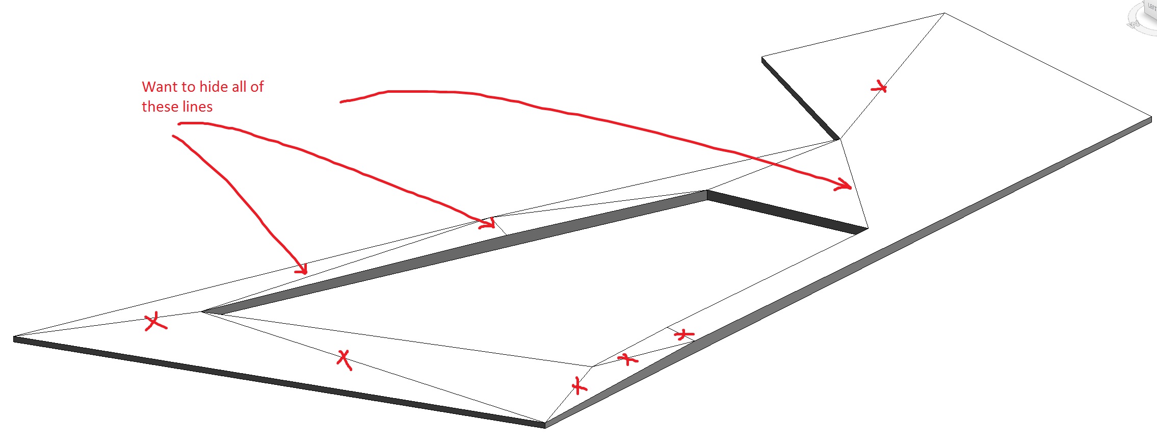

Hi all,
Is there anyway I can hide 'contour' lines in surface after I've done modify sub-elements on a flat roof to create falls?
I'll pick up fall gradients in section and details, so I do not want to see them in 3D or plan views.
See attachment
Thanks
Lee

If it is a floor or roof - turn off interior edges in VG.

Many Thanks WWHub!
