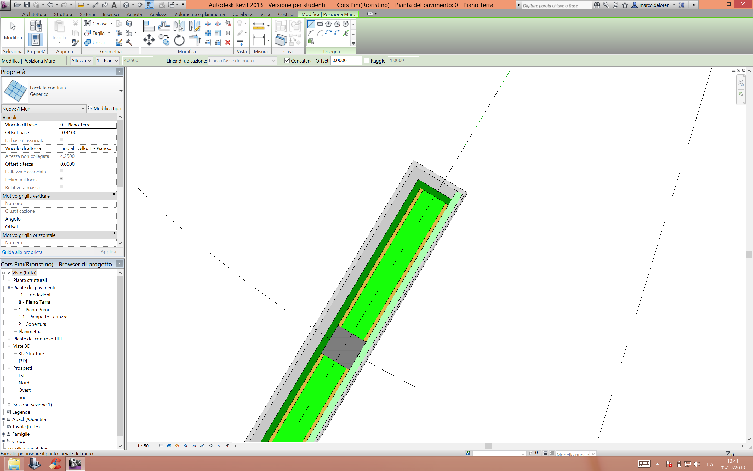

Hi everyone,
I have to create some walls with angled ends. have no problem in that creating a void wall-hosted family that cuts the guy's end. the issue is: this wall has many layers and using this method, these layers don't wrap properly at this angled end. what can i do?
P.S. how can i choose which layers have to turn at the ends of the walls and which not? is there a way to do that?(in the image i would like only the last layer on the left to wrap the wall end)
Many Thanks

Since this is just a 2D problem, use the edit cut profile tool.

actually, it is not, because i need that wall to have that shape in 3d and to appear with the correct connections of the layers in plant when they turn at the angles of the end..

Only the outer layer is visible in 3D!  The finished exterior limit is where you have defined it.
