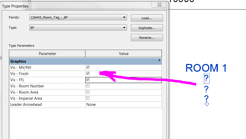

Hi all,
M trying to create a room tag whereby I can modify the visibility of the labels to what I need in certain instances. Have managed to do so to a certain degree however, the new tags that I have created shows a "?" sign even when the visibility property if turned off. Any idea how to fix this? I need this for an upcoming project submission.
Have attached the file with the problem

From what I can tell this tag works ok. I don't have the shared parameter file to follow it thru all the way but the visibility 'type' parameters seem to work and I get get rid of the '?'.
Click the tag after placement, go to the type properties and turn on and off what you want. See attached. . . worked for me.
There are overlapping parameters (visually) but that's by design I assume.

But every time clicking on the tag and then turning it off, is quite time consuming and irritating..?? can anyone suggest some of the other solution for this problem..??

Maybe it would be better if these were type parameters.
