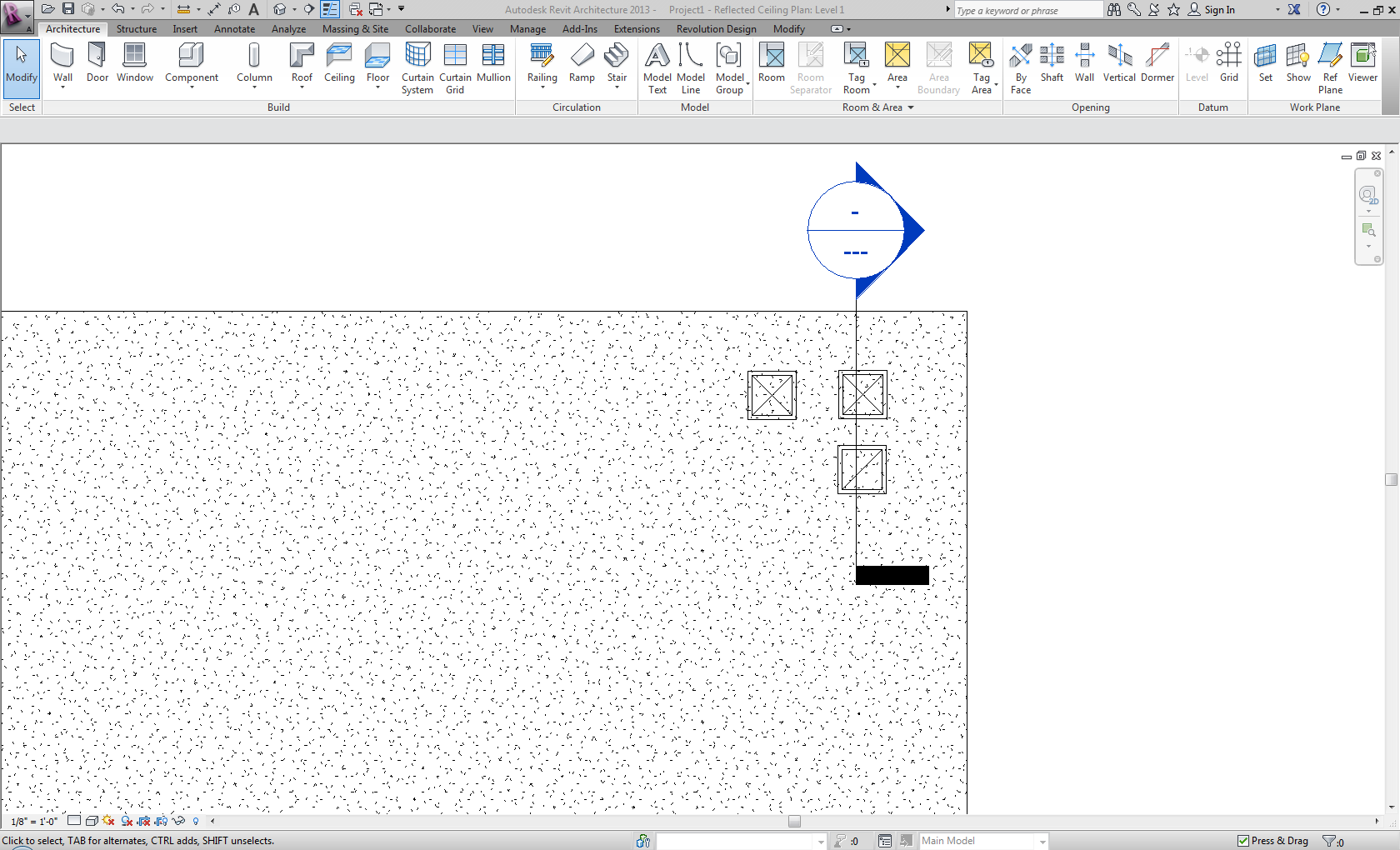

I am using Revit 2013 and I am placing the 2D diffuser that came with the program (out-of-the-box) and when I place the diffuser in my RCP on ceiling with material (gyp. board pattern) the diffuser seems to be transparent. when I edit the family I am aware that it is only 2D line work so I tried placing a masking region in the family. I load back into the project and it still shows trasparent. is there a step i am missing while placing the masking region or is there another way to have the diffuser show non-transparent?

I believe I attached a screen shot of what I was talking about.

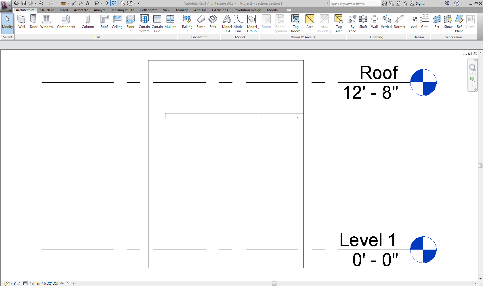

Thanks . . . . I don't see an attachment from your previous posts. I'll check it out . . . . How about another screen capture of a  Section that cuts right thru the difuser.

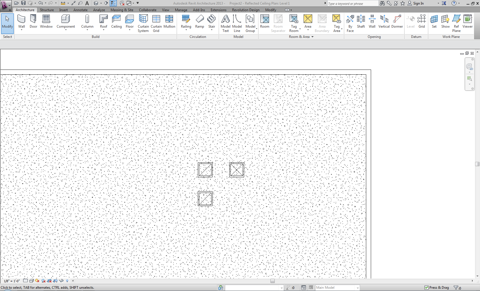

I have attached screen shots of the section and rcp

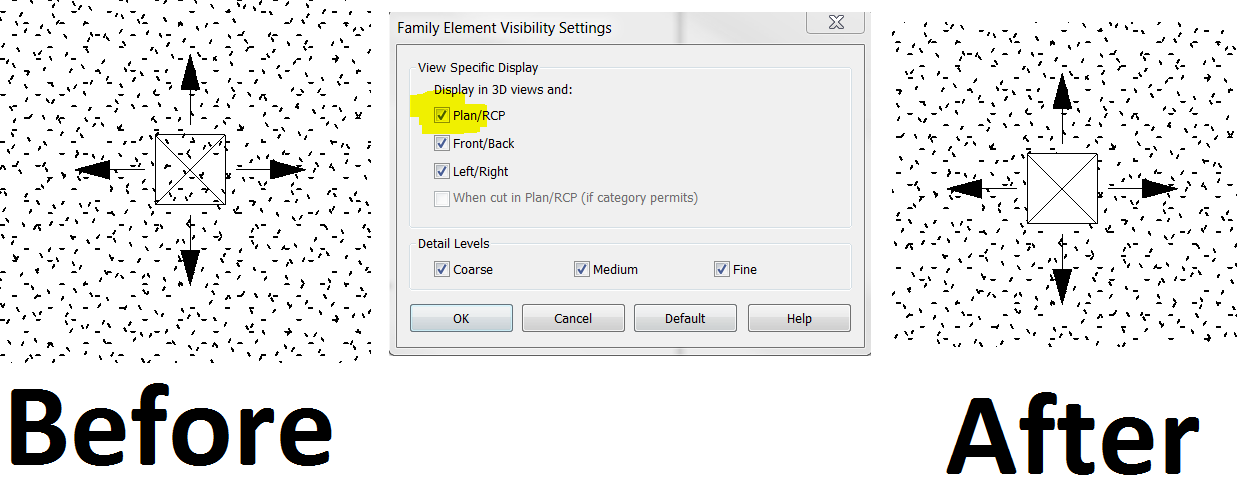

So this is typical REVIT family visibility graphics.
The 'Solid Blend' that forms the physical diffuser is actually turned 'Off' when the family is viewed in a plan view and 2d linework is turned on. This is regular REVIT family behaviour and done so to speed the drawing up by 'hiding' the 3d aspect of the family in certain views.
To fix this just open the diffuser family, then click on the solid blend (not the linework) then on the properties click the "Visibility Graphics Overrides" button and set Plan/RCP "On". Then reload the family into the project.
See attached before and after image.
