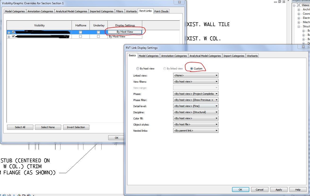

ok so that makes the VG box live again, but still not sure how to turn off Grid lines and levels off on the linked model.

Under VG>Revit Links> Display Settings> click on By Host View and in the RVT Link Displat Settings dialog box change from By host View to Custom and turn them off there.
You need to spend some time with your help file and check out some tutorials on linked models, worksets and view templates.
