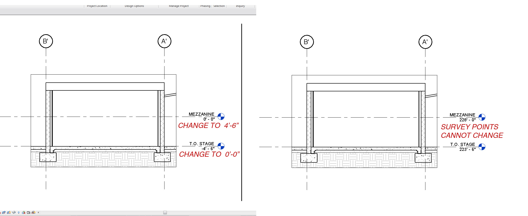

I am attempting to change my 'Project Base Point' levels while keeping the same 'Survery Point' levels. In the attached image I need the -4'-6" level to now be 0'-0" but the survey points need to stay exactly as they are now.
I do not want to move the project. I am hoping to just visually change the level heights. Hopefully there is a simple process that I am overlooking... but I did quite a bit of searching and reading before posting this. Thanks for the help!

To clarify, the buildings and site are not moving. The levels just need to be renumbered to simplify the documentation process.

I am having a rough time figuring this one out. Everything I am reading help and online is saying to set the elevations to 'survey point' then use the relocate project command. This is not a viable option as I need the survey points to align with the civil engineer's data.
Is there a section of the help file that I did not see pertaining to this? Since I need to change the numbering on the 'Project Base Point' Level setting I was hoping actually moving the base point up the needed distance would do this trick. Just like relocate project, it changes the 'survey point' but not the 'project base point.'

This video may help you:
http://www.youtube.com/watch?v=BigvY4LT-RI

That do it WWHub. Thank you!
I wasn't 'unclipping' the paper clip previously as I changed the project base point elevation.
