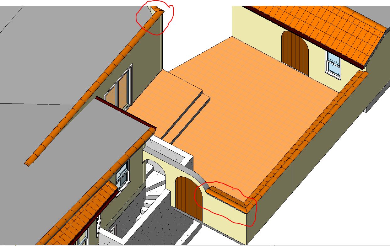

So I have this tile coping. I use a sweep and give a pattern to the tiles to imply the overlap. Still sometimes when I make a new one the pattern doesnt make the turn.
The screenshot shows the tile coping where the pattern failed. and a small area showing that it trully does work.
does anyone know how to Fix that? Should I just redraw the whole in place sweep?

you have to divide each paths and create sweeps seperately.
