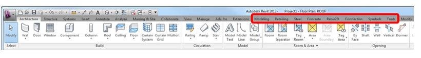

i hope i understand what do you require, but can you try this links:
http://apps.exchange.autodesk.com/RVT/en/Detail/Index?id=appstore.exchange.autodesk.com%3apopiconforrevit2013%3aen
http://www.popiconsoftware.com
i saw their screenshot and the can organize content by modelling, detailing, etc etc
and
http://apps.exchange.autodesk.com/RVT/en/Detail/Index?id=appstore.exchange.autodesk.com%3afamilybrowser%3aen
www.kiwicodes.com
