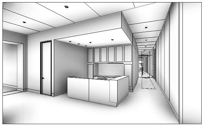

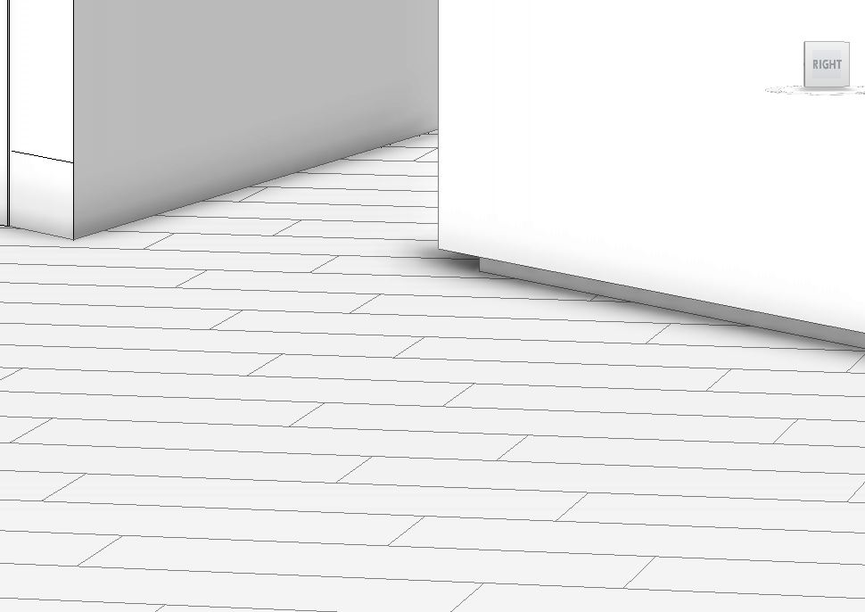

I am having trouble with 3D views.  This has happened multiple time and I am not sure how to remedy it.  I create a view and I cannot see the floor pattern but then when i zoom in really close it shows up.  I am not sure if it has to do with the angle of the view but either way I need to know how to fix it.
HELP!
THANKS

Patterns at an oblique angle to the view that become too intense will not show up.  And if the view is too small when printed, they will not show up there either.
