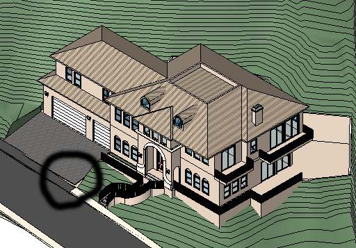

Thank you i figured that out about 2 mins after i posted this since i got no answer on the multi sloping drive way maybe you know how to do it.. i need a driveway that slopes away from the street and also that slopes with the street.

here is the image to help maybe.
