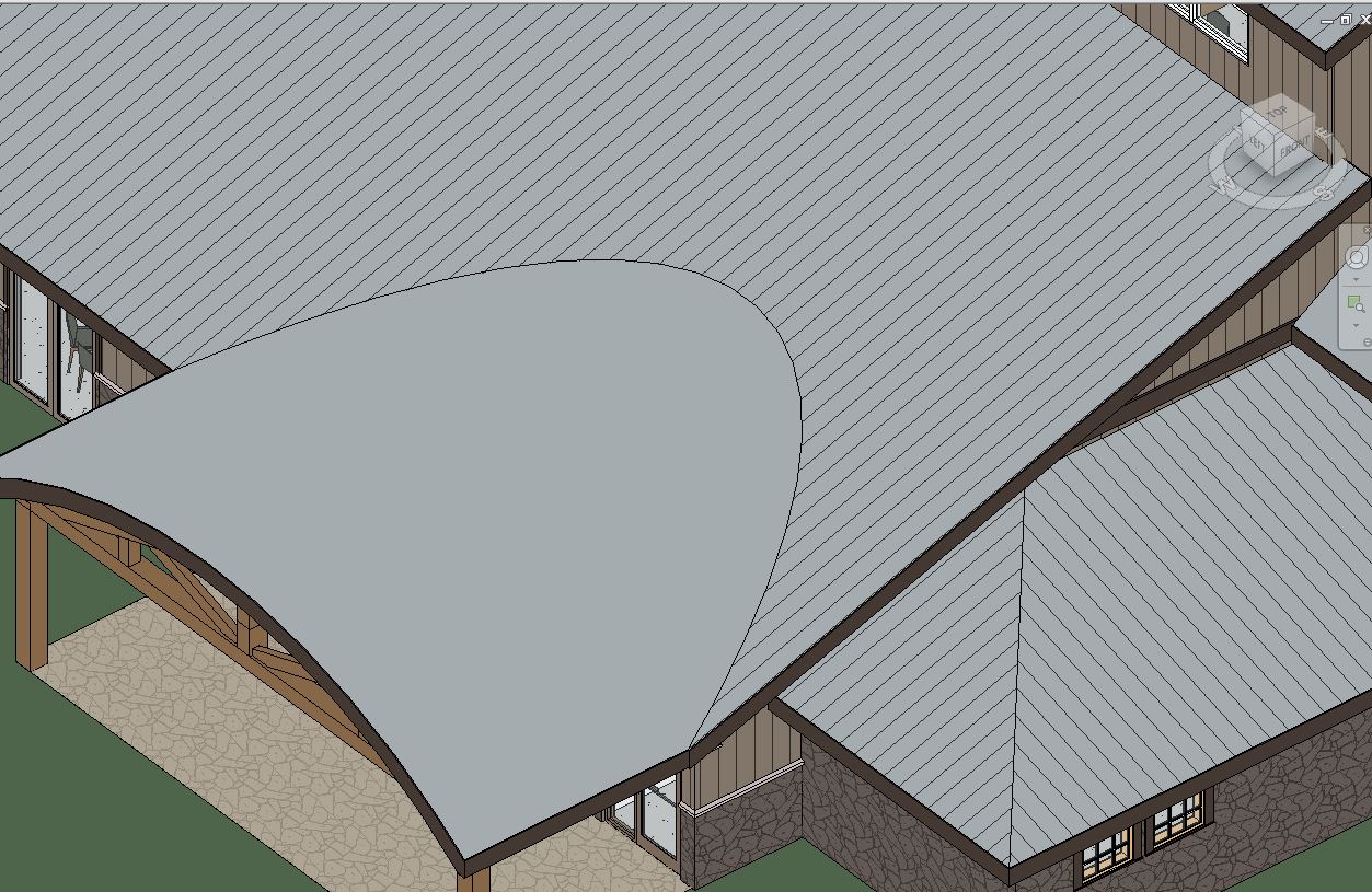

I'm using Revit 2014, trying to get a standard vertical pattern to run on a curved roof portion.  I created the roof by first creating a mass and then creating a roof from that mass.  The top material is the same standing seam as the other single slope roof that the curved one dies into, but no pattern shows up.  How can I fix this?  Thanks.
Wed, Nov 13, 2013 at 10:43:37 AM | Can't get a hatch pattern to appear on a curved roof
I would not have used a mass.  I would have created the roof by extrusion and the materials would have worked.
