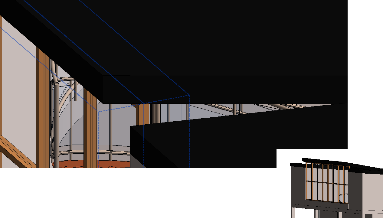

Hi guys!
New one here from the netherlands. Started with revit last week and trying to do something.I have a small problem: how do I close the gap between 2 different heights in for example a roof?
See attachment.
Thanks Smile

You model like you build.  You will probably need a short wall there setting on the low roof structure with the upper roof on that.
