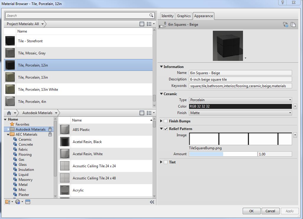

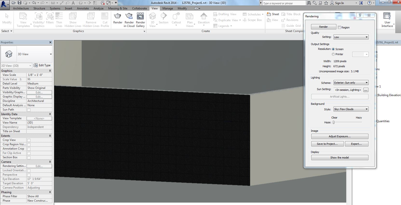

I've modified the standard 6" tile pattern in Revit, to a 12" tile in a black colour. When I render it turns out GREY! Someone please help!!
Attached pictures for your reference.
THANKS SO MUCH!

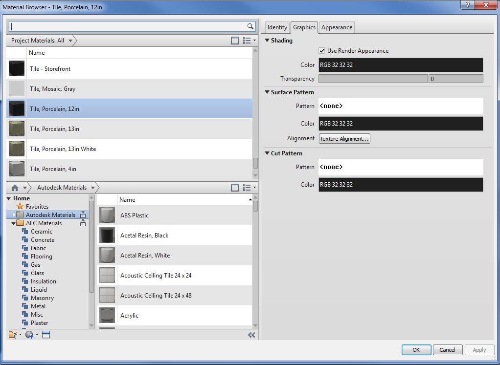

What other information do you need? I attached the 3 pictures above that have all the settings I used for the Tiles.
See the attached. I started a new project and did the same thing modifying the tile.

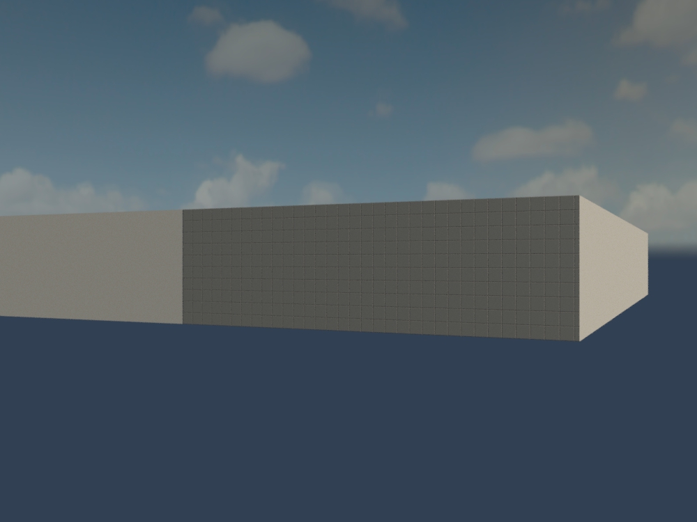

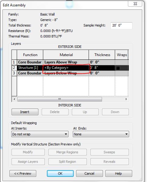

First off there is no material applied to your walls see picture 1. Secondly I don't know why you made an in place extrusion for the other "thin wall" instead of just a wall.  Thirdly I have no problem rendering it, see picture 2.

AbsoluteBIM - In my actual model, I have it in an enclosed space (roof, walls, floor) without walls on the ends - similar to a mall hallway. I've tried to set it to 0,0,0 (Full Black) and it still turns out grey.
Teafoe - I created it as an in-place wall. It's for a storefront so I have to wrap around corners, switch from full height to a 4" base, etc. So it's just easier. HOW DID YOU GET IT TO WORK !!!???

In your materials under the Appearance tab change your Ceramic color from RGB 32 32 32 to black or RGB 0 0 0.  I thought it was a phasing problem at first but it is just a color problem.  It is seeing the RGB that you currently have it set as a more gray than black.
This is the file that you gave me, I just changed the material.  Try rendering it and see if you still have the problem.  If you do make sure that you have all of the service pack updates installed on your version of Revit.

I just wanted to let everyone in this post know that the problem is resolved.
I changed the Tile material from Porcelain to Cermaic, and it rendered perfect normal, showing the exact colour(s) I want.
Obviously there is something messed up with the Porcelain material in that file.
