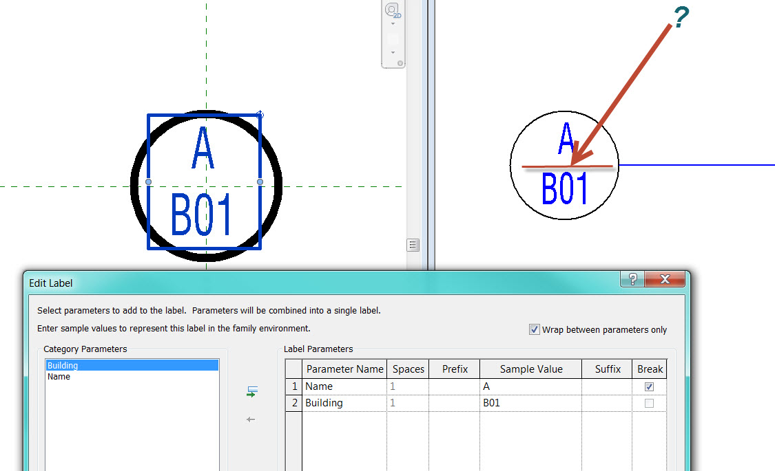

I have a Grid Family with two information, Grid Name and Building Name, I have them combined in one label. The question is how can I put underline on the Grid Name without the Building Name parameter be affected.

Is it possible to use two separate labels with different text types. Or what about drawing a line?

@archigraphics. i think that is not possible. Sad

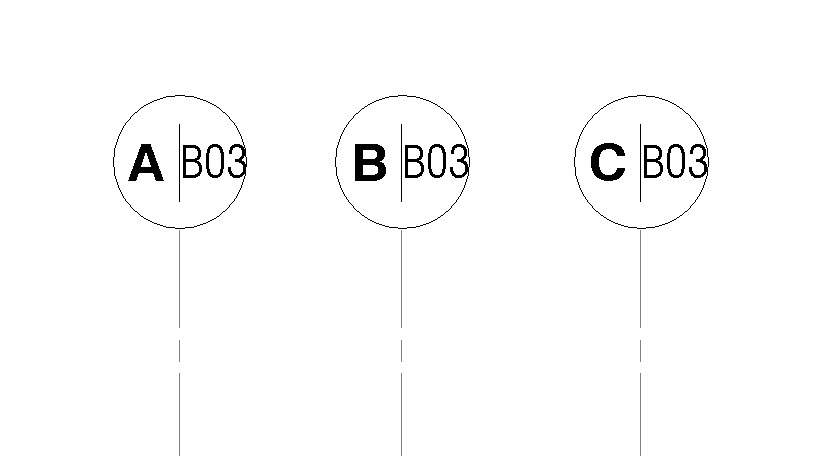

It's possible to have 2 or more labels per grid head family (to separate parameters and text styles). It's possible to have different grid head families applying to different axis (to deal with the auto-rotation that revit makes when the axis is horizontal).
