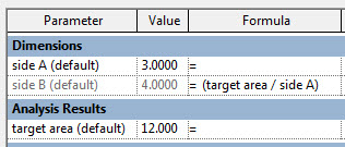

See illustration. Three parameters: "side A", "side B", and "target area". The length of one of the sides is driven by a formula. The other two parameters, one of the sides and the target area, can be changed to calculate the lenth of that other side.

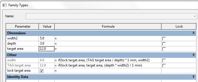

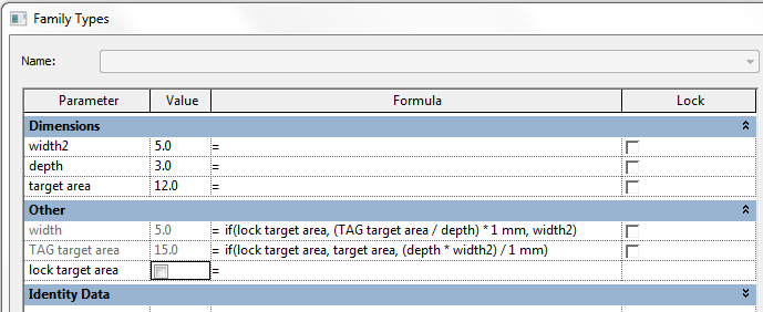

hi,
if youre trying to achieve is to have the width automatically calculated when locked?
and key-in/define its value when its not locked?
right? if yes see attached files.
if locked:
depth = define depth
area = define area
width = area/depth
if unlocked:
width = define width
area = width*depth

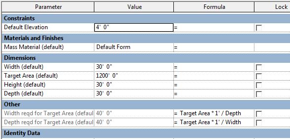

Ron, what you proposed isn't quite what I was after but gives an interesting workaround. My custom TAG lists both the target and actual areas. I didn't want to toggle between them. But, I like the idea calculating the value to be entered to acheive the target area, like in the attached. So, if I stretch the width, the family gives the depth I need to enter to acheive the desired area, and vice versa (see attached). I can live with this. You could say I was trying to acheive this end without having to key in the value.

Well, of course, in my proposed solution, only one of the two sides is flexible, and the other one is constrained by the value of "target area". That is why I named the two sides "side A" and "side B", so that, if necessary, you could rotate the element, to make the width be the depth, or vice versa. If the two sides were flexible, the area would not be constrained to a target value.

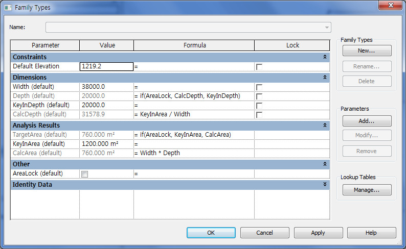

you need more parameters for both, depth and area
see attached image.
hope it helps.
