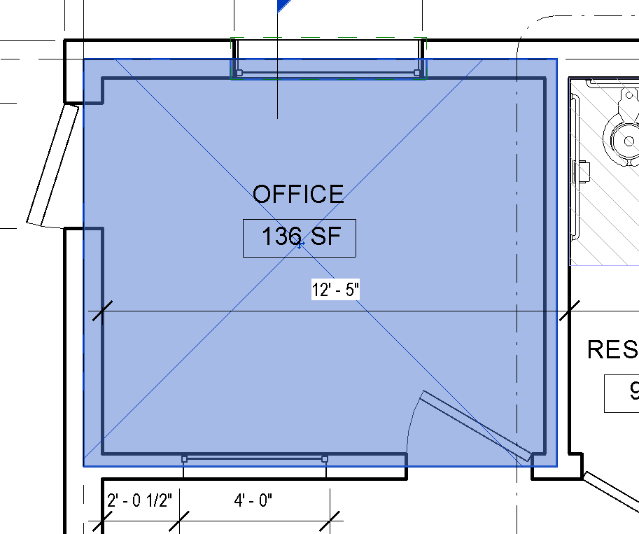

Hi,
Is there any way that I can edit room boundaries?
Refer attached snapshot - i would like boundaried from finish face exterior for external walls & centreline for internal walls which is ok for the moment.
I know there are room computation settings but that does not help me in achieving required out.
P.S - I have gone through some of the posts in revit city
Thanks
Rams
Now on the implementation stage....
Tue, Oct 29, 2013 at 1:15:03 PM | Room Boundaries
Select all of your exterior walls and turn off room bounding.  Then simply add a room boundry line along the inside face of your exterior walls.
Tue, Oct 29, 2013 at 1:23:19 PM | Room Boundaries
Rams
Joined: Fri, Mar 28, 2008
128 Posts
3 Stars: 3 Votes
Thanks WWHub. I added rom separation lines & turn off roomk bounding as you suggested & it works fine.
Cheers
