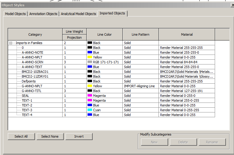

Mon, Oct 28, 2013 at 1:43:00 PM | Best way to import
The answer is still in your HELP.
First - you asked about color - not material - and under sketchup imports, it telss you:
Specify the desired import settings. To import SKP files
  • In the Import CAD Formats dialog, navigate to the folder that contains the SKP file.
The following settings are recommended:
  • Colors: Preserve
Now you are asking about materials.  FIRST RULE _ THE PROJECT RULES!  Whenever a material is set in the project - it can oly be changed there
Second  - skectup is imported as a CAD file.  When you read your HELP, you will find that you can assign materials by category - so you look at your manage tab dropdown - object styles and look at this tab:
Keep reading your help......
