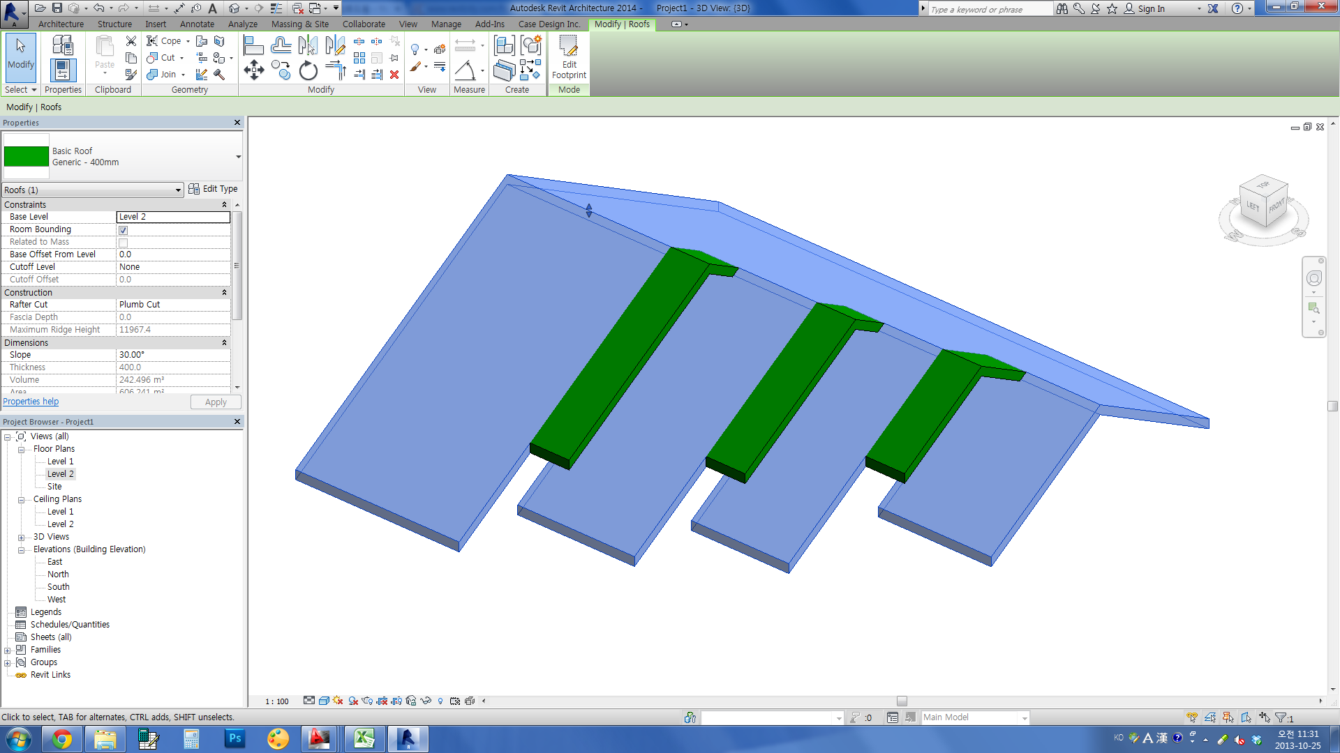

I have a stepped roof configuration in plan for a building. Each roof has the same pitch and is stepped in planEach stepped roof must have an overhang. Howvere when constructing the roof line REVIT does  not allow for overlapping roof lines. I have enclosed a screen shot that shows the building in 3D and what I need to have happen. Is there a work around to accomplish a stepped roof configuration with overhangs without REVIT giving error messages.

gday mongooseST1,
draw up a few handy reference planes, then
try doing the roofs as separate extrusions,
this way u have control of the roof segments,
 then use join geometry. after using join geometry you can still adjust verge overhangs of each roof segment.
just make sure the individual roof planes are same pitch and pitching point, ie at core or ext face etc.
cheers
geoff

That does NOT work. As I had said earlier using the ROOF command to edit the roof as you have stated I run into REVIT errors. While the extrusions using separate work planes sounds great. It is easier said than done...I am having trouble getting the Set Plane command to work on once piece of roof so I can get to the extrusion command that Geoff describes. Moreover, where is the extrusion command on the toolbar at top of REVIT 2014. I see nothing regarding extrusions

u can find the ref plane command under architecture tab  (look on rh side of menu bar at top)
draw ref planes in plan view, give each one a number or name. number is easier.
roof by extrusion is under architecture|roof|roof by extrusion.
when you pick this it asks for a ref plane.
select one you just made and get making that roof. ( remember the roof will be just 2 lines, unlike a profile).
the roof will have the same properties as if you used the roof by footprint command, as far as layers etc.
cheers
geoff

I have used the roof extrision command to place the various roofs. REVIT will only join 2 planes but not multiple planes AFTER one has joined the FIRST roof with the second roof......Again The creation and joining are easier saidd than done.

the way i approached it was to form a set of gable roofs.
that is /\ so you already have 2 slopes joined.
my version is a series of these roofs, different spans of course with
same pitch and pitching point.
see attached

Here is a video for you.
hope this helps.
http://youtu.be/CA14bC6bx7Y

To DINGOHOT..................HOOYAH!..........The video is worth 2000 words!.......GD!!! it is GREAT Solution and certainly helps in completing this project.....Easy, clear and consise
