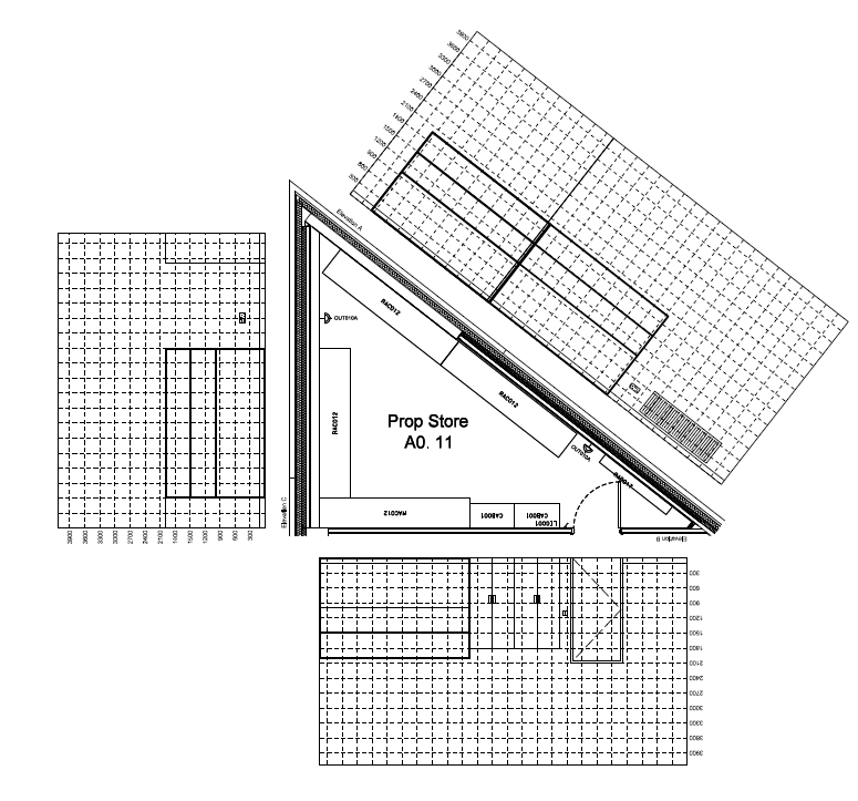

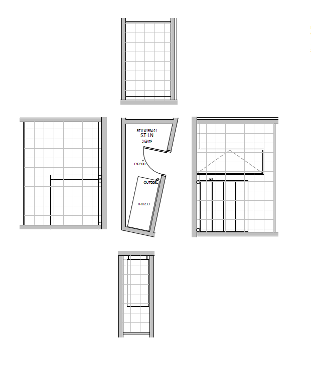

I tried this on a section/elevation/detail view and found 180° works perfectly, but when I try rotating by anything other than 180° the elevation/section/detail view flys off to an odd rotation (not the desired).
I have tried a few things like putting a minus before the degrees and subtracting the degrees from 360° and it still changes to an odd angle.
The reason we want to rotate it by these amounts is because we are trying to creat C-Sheets with elevations of each wall within a room. we want these elevations to appear like a fold out of the room and where we have angled walls we want the elevation to follow suit.
The attached files illustrate the issue quite well. The AutoCAD C'Sheet is an old example of what we are trying to achive. The Revit is where we have got.
Any ideas?

Kind of figured out a solution for this. If you creat a callout from the elevation or section any rotation works.
It is strange why this cant be done in all view types though!
If you do know how to do it to other view types like sections, I would still be keen to find out.
