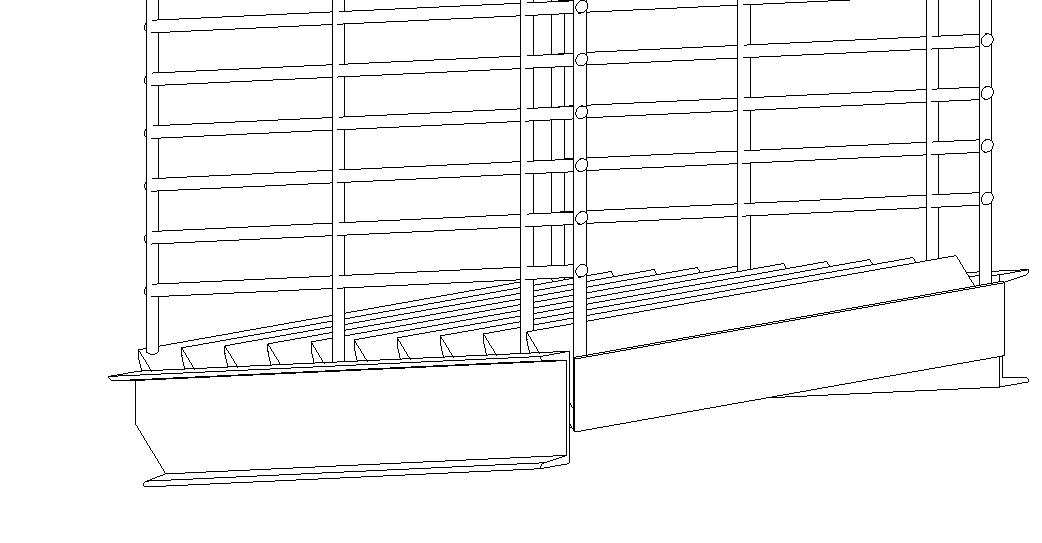

2014, trying to make a c channel support for stairs but the profile is not aval. in the properties menu??
how do i load this into the project?? like in this tutorial...

In your project go to insert>load family>find the profile you want for your stringer and load it into the project.
Mon, Oct 21, 2013 at 4:07:01 PM | how to load c channel profile into a stair support (stringer)
NOTE:  That profile's usage has to be set to stair support in the family.

tried to load the profile.. it just doesn't load or work.
even when i copy the profile and make it stair based????
Wed, Oct 23, 2013 at 3:23:09 PM | how to load c channel profile into a stair support (stringer)
You have to use stair by component.

still won't work no way
Wed, Oct 23, 2013 at 3:59:19 PM | how to load c channel profile into a stair support (stringer)
What Revit, what update?  Always start with that in your posts.

same as before...2014 revit
in the video (http://designreform.net/learning/2012/05/14/revit-2013-component-based-stairs)it works so good???
how do i get this profile in myb template?? maybe it would work from there??

2014 has an update - install it.
Thu, Oct 24, 2013 at 8:11:43 AM | how to load c channel profile into a stair support (stringer)
#10
I just looked at the profile used in a new project using a standard template.  The profile is assigned "generic" and not assigned to stairs.  Try a new project using the commercial template.  You will find the channel profile there.

yes finally this works thank you
