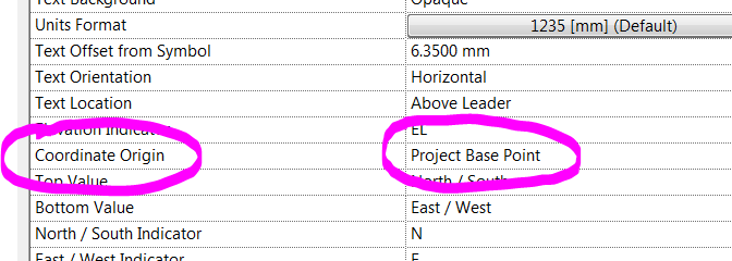

Hi every one new to here not new to revet. I am using 2013 and we and to use spot coordinates from project North not True north. Is it possable to change how the tage reports its coordianets to project north.
Thanks,
Jeff

Change the Type Parameter  > 'Coordinate Origin' of the Spot Coordinate family to Project Base Point.
See iamge.

Thank you that was driving me nuts.
