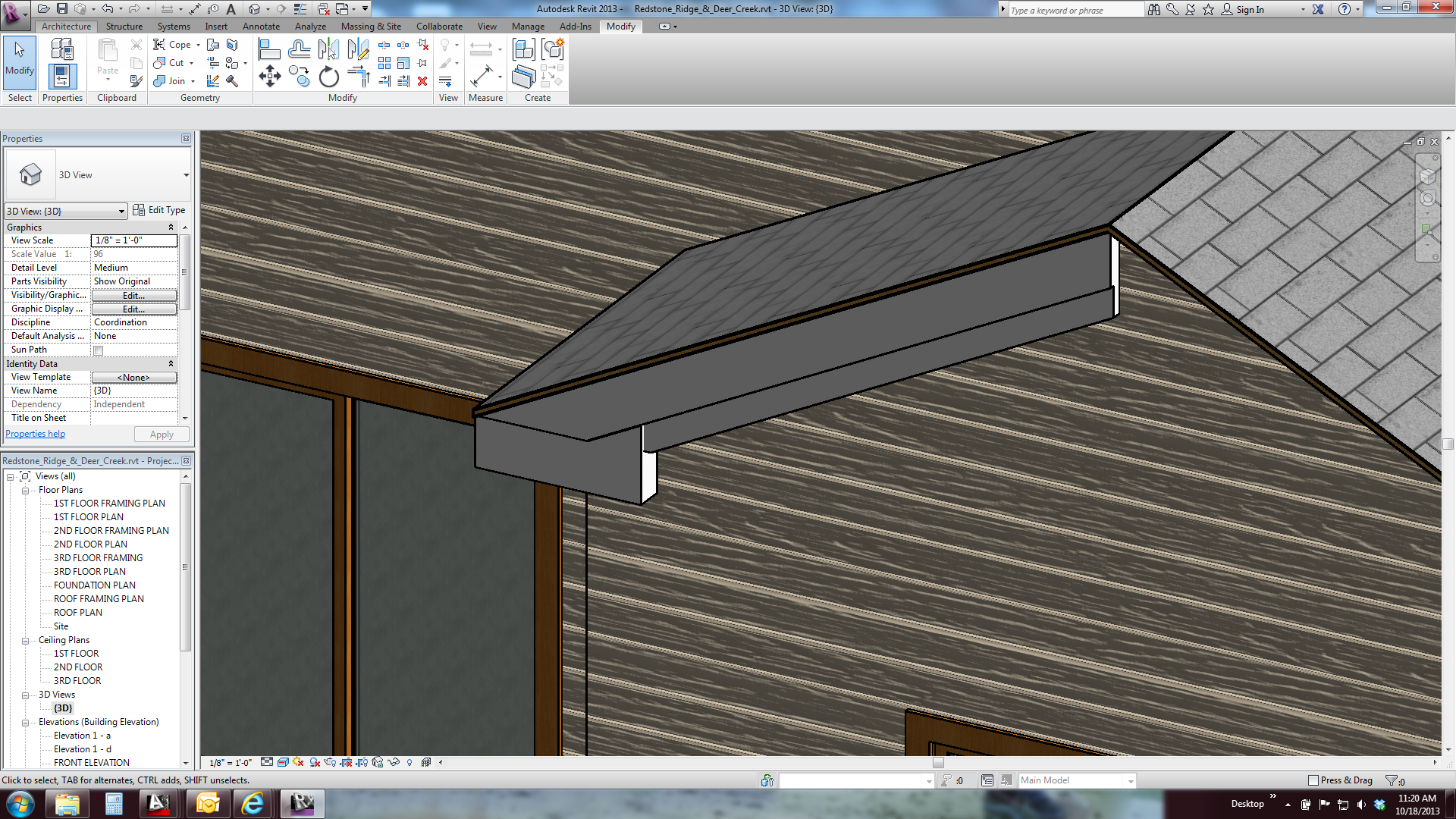

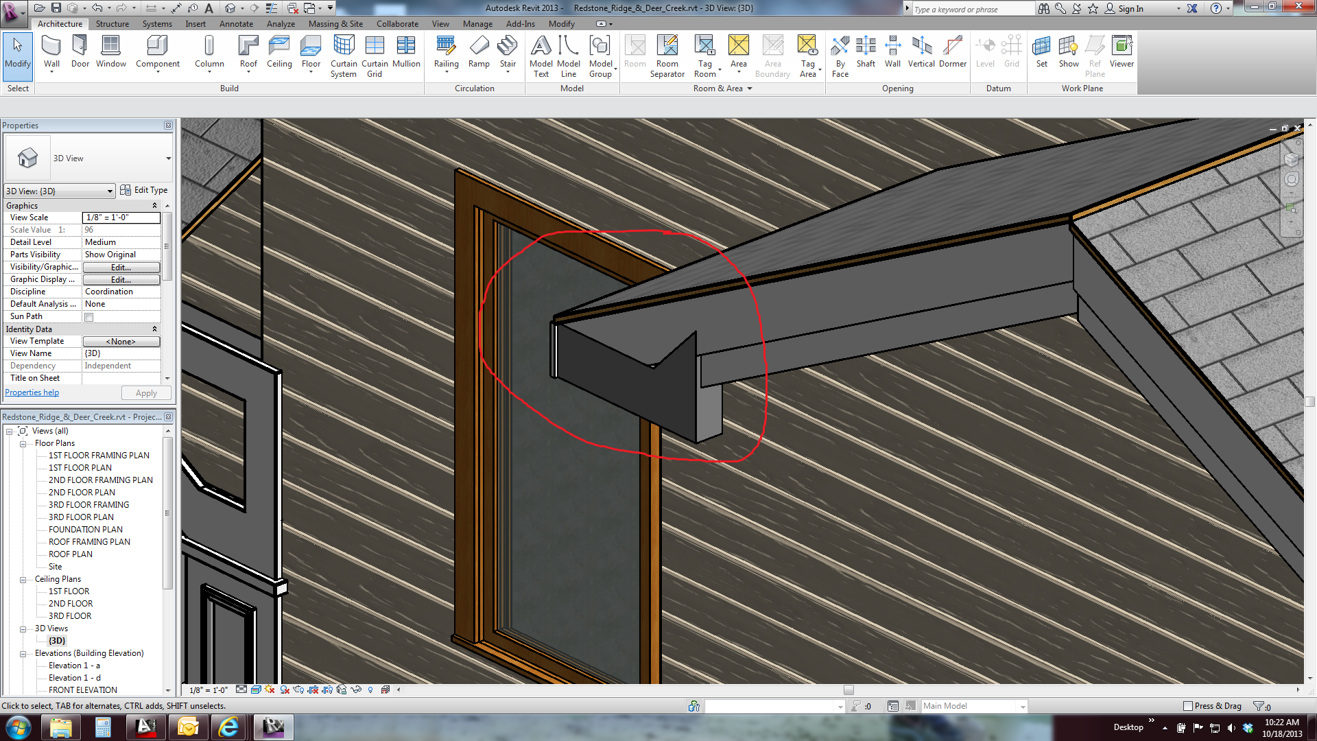

I've used the roof fascia tool to create the rake and I created a component for the return.  When I try to join the two together I can't get them to blend together to appear as one smooth transition.  What am I doing wrong?

You made an in-place component for the return?  What is the weird angled part?  Are they the same material and category?
Also jsut a note, it doesn't appear your ridge line meets correctly.  Did you do this a 2 separate roofs for some reason?

Thanks Tea, not sure why I did two seperate roofs either.  I've adjusted based on your suggestions.  I actually created a family for the return, its a generic family, do think that could be the reason they are not joining?  My goal is to create the roof trim in a quick, repeatable fashion using the roof fascia tool and the family I created.
