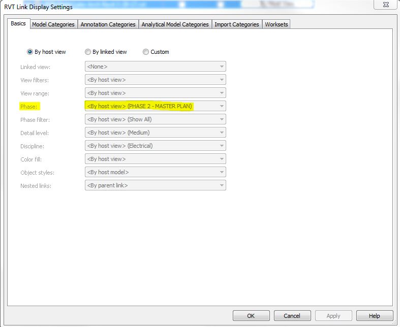

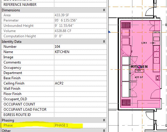

I know this thread is old but one thing that i haven't seen many touch on is to verify that the phasing of your project matches that of the linked file. To do this you will want to open up the linked file. Once the linked file has opened, TAB around the corner of a room until the Room Boundary is highlighted. Once the room is highlighted, take a peek at the Properties palette under "Phasing" (I have attached an image that shows that when this room was created, it was created under Phase I). Switch back over to your local file thats giving you all the issues and open the template applied to the sheet (with no template, enter VV or VG). You will want to open the "Revit Links" tab, then under "display settings", verify that the "Phase" in your project, matches the phase that the rooms were created in (I have attached a second image showing that while the phasing of the linked file is "by host view", the phase differs from that of when the rooms were created. Click on the "Custom" bubble and then make the Phase match when the rooms were created, in this instance, Phase I. You should now be able to Tag All rooms. Hope this helps anyone who happens to run across this issue after trying all the other possible solutiotions!
