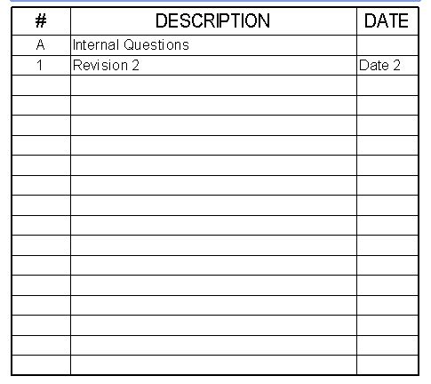

So I've looked through the topics, and can't seem to find an answer I'm looking for.
I use the built-in revision cloud and revision schedule for my title block, but the problem is sometimes I also use revision clouds as a way to ask questions or call out notes.  I've made a seperate revision/sheet issue for these cases, but when I use the revision cloud, the revision name shoes up in my shedule on sheets.
Has anybody come across this problem? I wish there was a way to not show certain revision on a sheet (even though the drawing has a cloud on it), or a way to filter them out in the schedule properties.
I've attached an example, I'd like the "Internal Questions" to not show.

There is not a way to show a cloud but not the issue date.  I don't think it is a great idea or practice to do things the way you are doing them.  Revision clouds are for revisions.  You could create a symbol such as a box with a special color to place on your sheets for internal use.

I completely agree, this isn't the best practice. I work for a construction company, and many times our superintendents and layout crew want to keep track of RFI's that come in after revisions/submittals....which is why I cloud them and create an "Internal Qestions" or "RFI" revision.
Does anybody have, or does anybody know if it's possible....to create a line based family with the cloud linetype? I'd like to create a box with this, and be able to drag ends so it at least looks similar to a revision cloud.

hope this helps.  I leave the date and discription blank so the revision schedule doesn't populate any information it will only create a blank row and even if you add the delta, the delta will also be blank.  then if need it, i create a delta but instead of using revision label i use comments and and you can populate the delta with whatever you want without affecting the revision schedule.

Thanks Manny, that's exactly what I've been doing recently.  Leaving a revision blank instead of giving it a name and date.  Just gotta make sure it's always at the end so that there isn't a blank space between revisions on a sheet.
