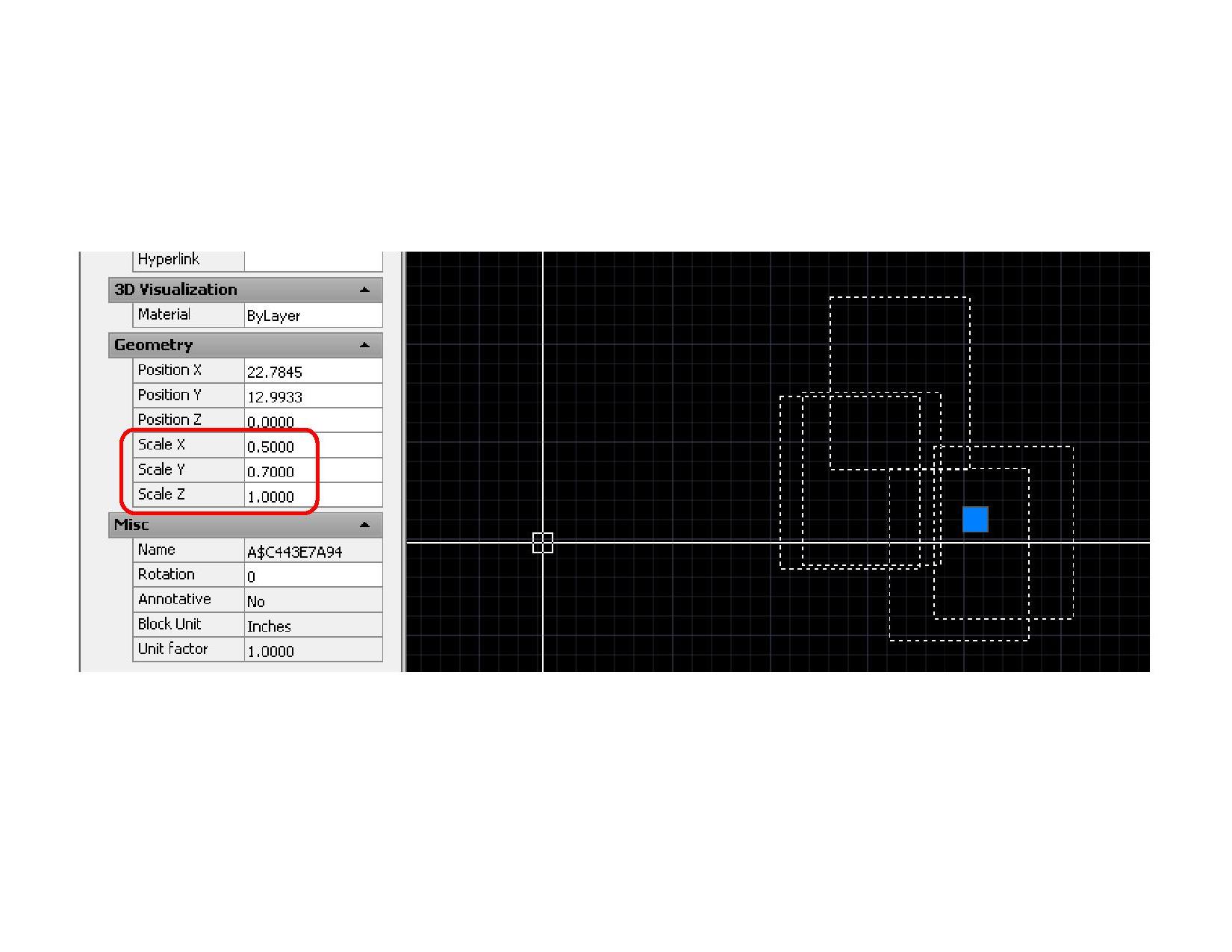

Hi, I am not spent on yours situation. I can divined that your CAD file ( drainage) wrong on block( scale ). You must check and make sure it's not be scale ( change to 1:1) _ That is result when link to Revit file.
attached figue is wrong block scale and must be changed to 1:1
