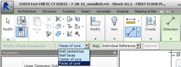

I am having the same problem with my dimension snapping to the wall center line and not the core center line.  I don't know if things have changed from 2014 to 2016 or I am just slow (probalby the later).  Could you point me to where the dimension preferences are in the options (R menu/options?).  I am having a tough time finding it.  All I can find is how to change the preferences for the temporary dimensions (manage tab).
Thanks.
Tue, Sep 1, 2015 at 12:16:51 PM | 2014 Dimentioning bug
On your options bar - see image.

Yep, just slow.  Thanks for the help!
