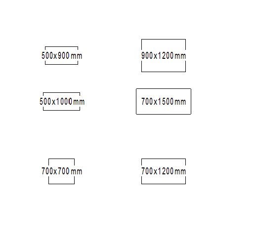

I'm doing a plan showing a variety of sizes of tables, and rather than tag the furniture I'd like to have a label inside the family object instead (object attached, with a nested generic annotation label).
I can get the label to show up, but it seems stuck on showing a single output, an instance parameter type mark, which i have as a text parameter.
It should instead show the type Mark different for each of the different types?
It changes OK within the Family Editor, just not when I have a variety of sizes and obviously Types on my floor plan.
Can anyone suggest where I am going wrong?

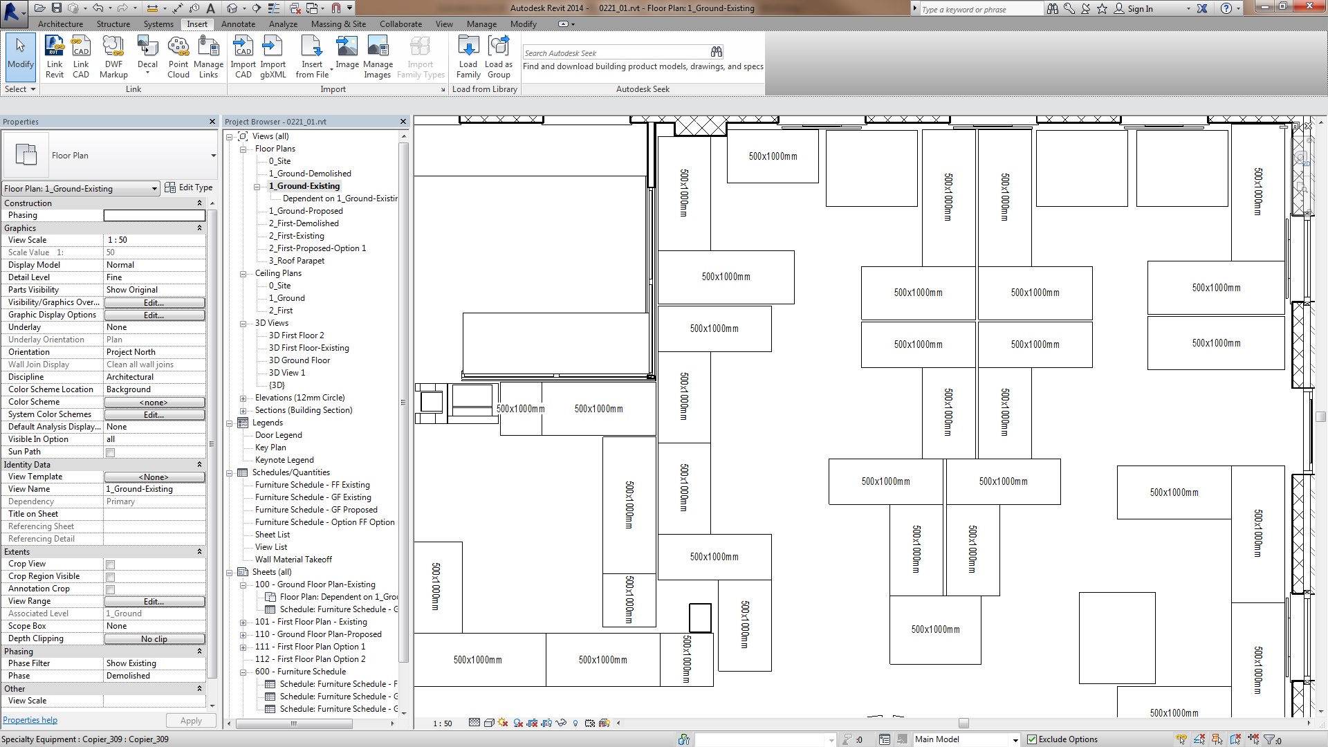

Tried that first time and didn't work so had changed it to By Instance, changed back to being a Type Parameter and unfortunately still doesn't work.
See attached for what i see on my plan.
Does it work for yourself though?
If so must be something else...

Dang, I wasn't reloading it into the project properly.
Do it right and it works....
Thanks for the help Smile
