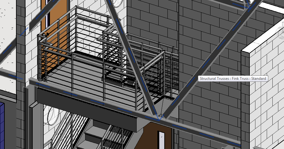

I am doing a component stair and railings. When I get to the landings there are portins where I do not want to have railings but when I delete the sketch lines  I get the following error.
The Railing line must be a single connected Sketch. If you want separate pieces of Railing, create two or more separate Railings.
Is there a way to delete portions of a railing? Or is there a different aproach to be used here completelly?
Thank You for any help

Your rail has to be one continuous line or can be made up of multiple lines as long as all lines are connected.  If you want another railing you need to finish the sketch and create a separate railing.
