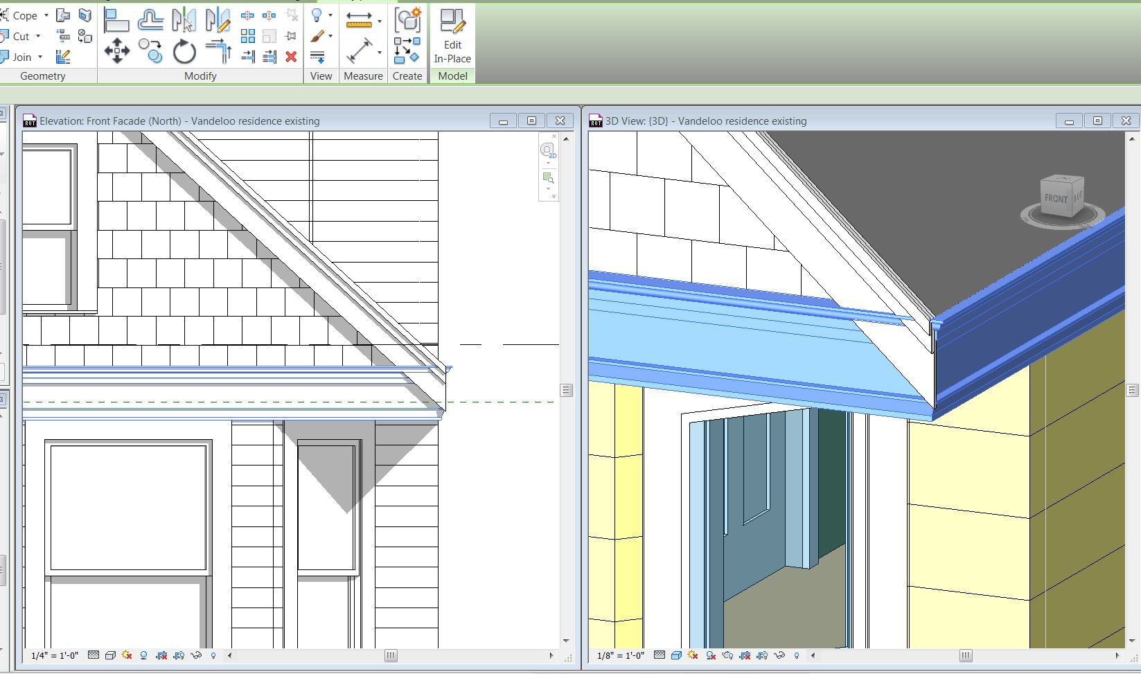

I would like to know if I can end the facia, with a horizontal flush cut. so that it dies into my horizontal wood trim details. 9see picture.) is this possible. or should I use an inplace and slice a sweet with a void cut?
Thanks in advance.

Have you tried an in-place void to cut the sloping element?
