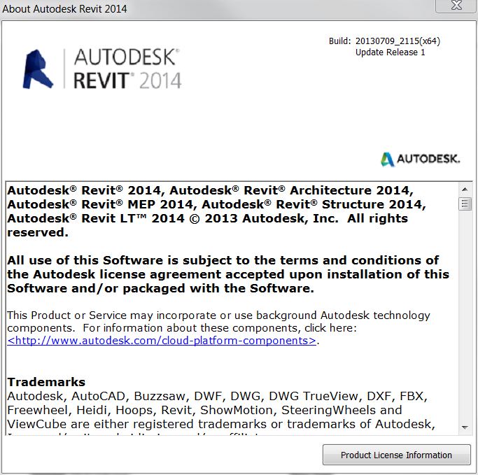

It's not the latest? Everything that I have says I'm up to date. See link referencing my build. What am I missing?

#10
You have always referred to build but there is more to this than build number.  In Revit, click on the down arrow to the right of the question mark.  Then click on about.  There you will see your build but below that you will also need to see "Update Release 1".  Regardless of the build number, if you don't see update, then you don't have the update installed.

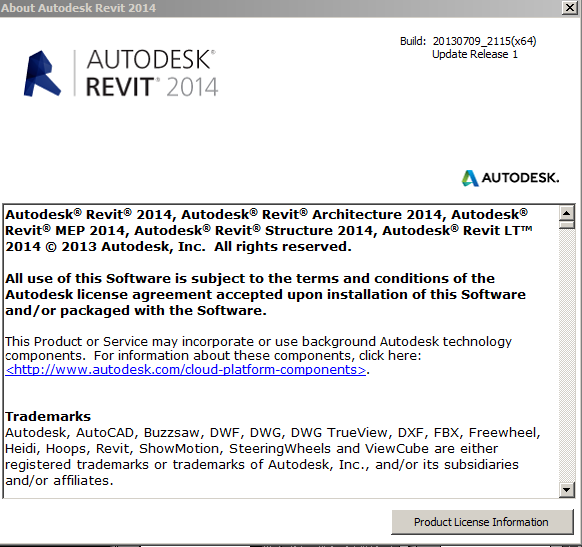

I thought I did. The Update Release 1 _IS_ build number 20130709_2115. In my experience the build number is the important number - the only unique identifier of a software distribution package. I would think it's possible for two builds (...2115 and ...2116) to have the same official name (Update 7), but it's not possible for two offifial names (i.e.: Update 3 and Update 4) to have the same build. Also, Autodesk confirmed that I had the latest build when they did the TeamViewer, by reading off the build number.
In any case, that's my experience, but I suppose there could be exceptions. See my screen grab to clarify.

#15
Perhaps you know what build numbers mean like autodesk does but we don't know them.  What we do know is what update numbers are appropriate for what release - no matter what the build number is (and there are different ones).
