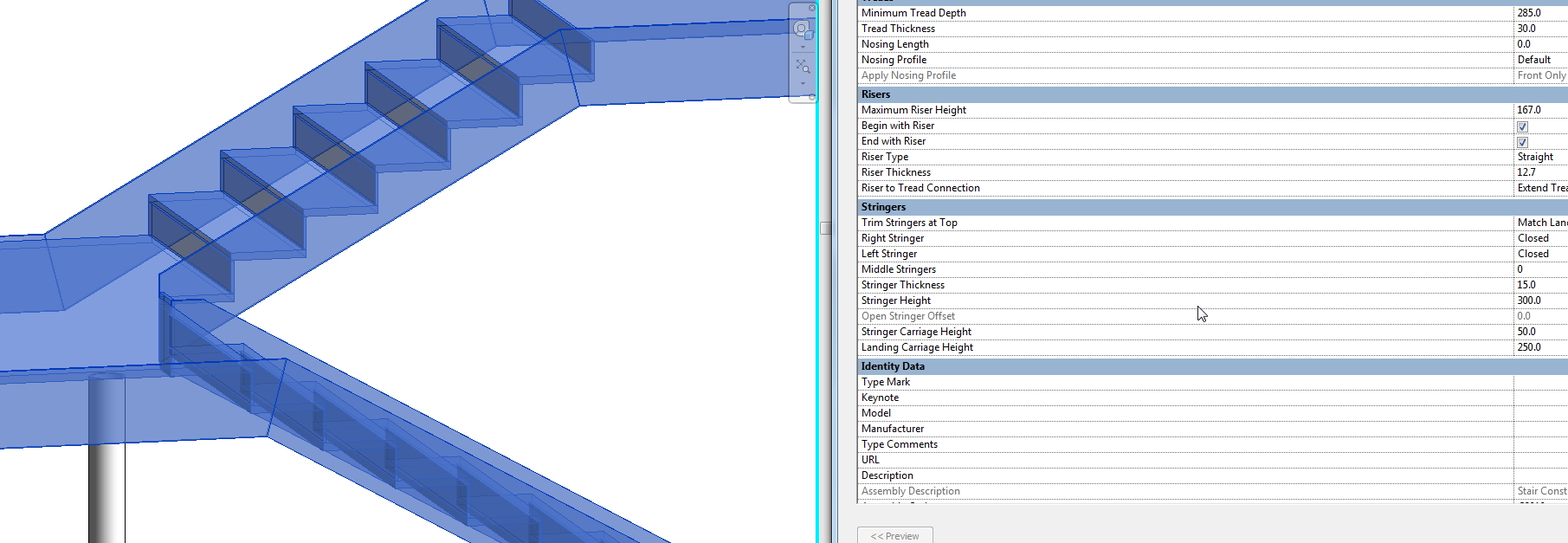

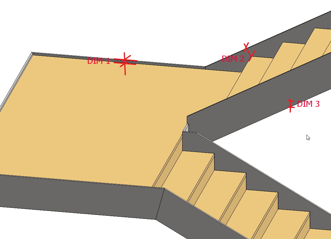

Is it possible to control the dimensions separately for stringers on the side and stringer on the middle landing?
My setting in Revit is:
Stringer carriage height=50mm
Landing carriage height=250mm
Stringer height =300mm
Tread thickness=30mm
So DIM 1 becomes 20mm, DIM 2 becomes 75mm and DIM 3 becomes 50mm
(Please see the attached picture)
What I want to do is to keep DIM 1=20mm, but change DIM 2 to 25mm and DIM 3 to 100mm.
I have tried to change the stringer carriage heigh and Landing carriage height.
However I have never got the result I wanted.
DIM 1 always changes together with DIM 2 and DIM 3.
Is it possible to keep DIM 1 but change DIM 2 and DIM 3?
Thank you very much

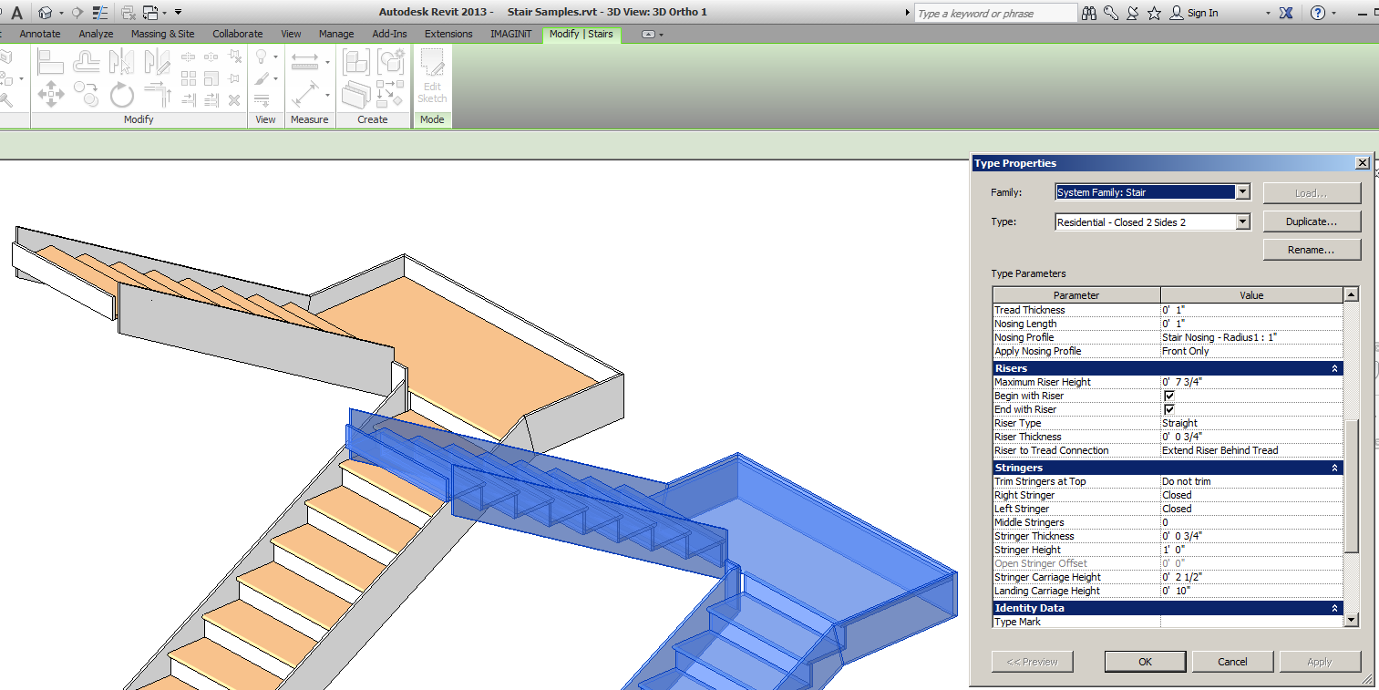

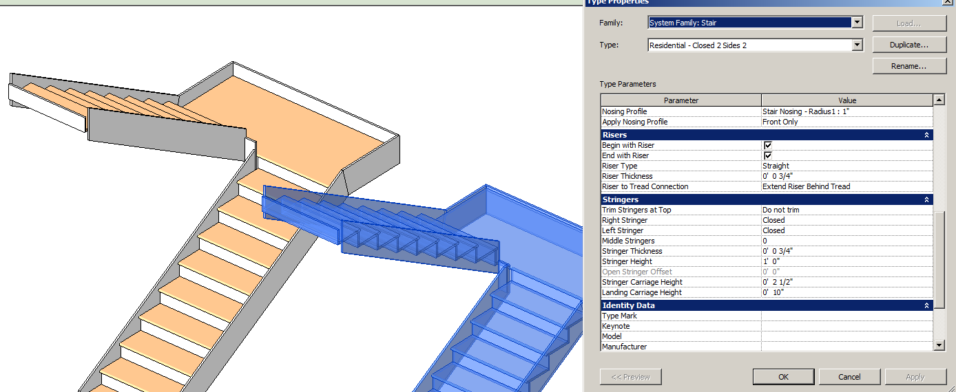

Thu, Oct 3, 2013 at 7:31:00 AM | Settings for stringer
Just change the landing carriage height.
The one on left is 5 1/2" - the one on the right is 10".

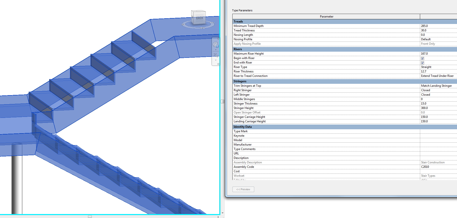

Hi
Thank you again.
I don't know why I couldnt make it like you did (keep DIM2 and 3, but change DIM 1)
Please see the attached pictures.
The first one:
the second one:
Stringer carriage height=150
Landing carriage height=150
My DIM 1/2/3 always change at the same time......

Thu, Oct 3, 2013 at 10:33:32 AM | Settings for stringer
Here is a 2013 model of the same set of stairs and it works for me.
Build 20130531_2115(x64)Update Release 3
Stringer Haunch (level off) at top of flight
