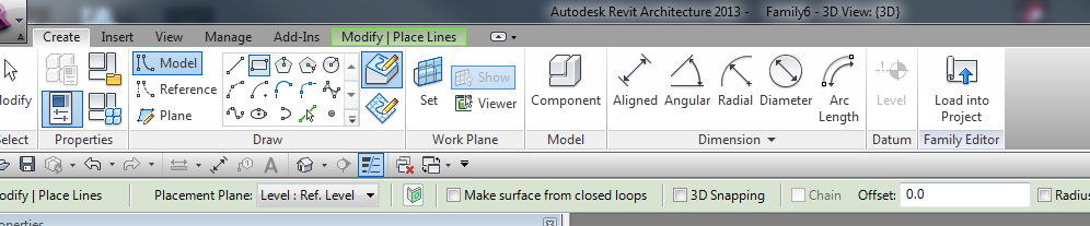

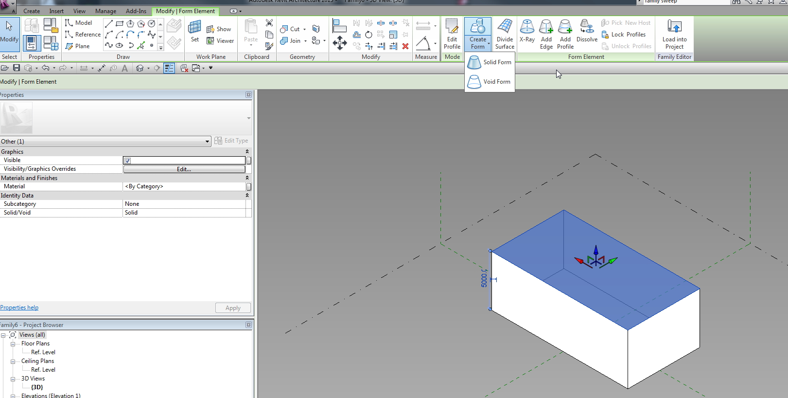

Hi
Thank you for your reply.
I use Revit architecture 2013.
Please see the attached pictures, I dont have sweep/blend...., only "create form" fuction.
Where can I find those fuctions
Thank you very much
Thu, Oct 3, 2013 at 7:36:21 AM | How to model Sweep/ Blend/ Revolve in family
teafoe5
teafoe5 Avatar
Joined: Fri, Nov 12, 2010
1749 Posts
4 Stars: 47 Votes
Your in a conceptual mass family, that is completely different.
Thu, Oct 3, 2013 at 7:38:44 AM | How to model Sweep/ Blend/ Revolve in family
You are using a conceptual mass template.  That uses the push/pull that you see.  Use a different template if you want traditional tools.
Thu, Oct 3, 2013 at 7:41:26 AM | How to model Sweep/ Blend/ Revolve in family
SINOSLO
Joined: Tue, Sep 3, 2013
17 Posts
Ahh, now I see.
Thank you very much :-)
