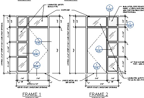

Hey!
Using Revit Architecture 2011.
All my selction bubbles, callouts, and elevation markers are blue. I'd like them to be black like the rest of the drawing.

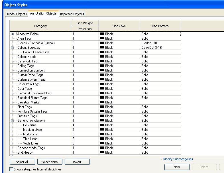

I checked the Visibility graphics for all elements and sub elements, but it says no overrides, and all are black.
(see attached screenshots)
Thoughts?
Thanks all!

The blue color is just an indicator and will not affect printing.  There is no way to change this in is part of the systems family.  It is especially evident in Levels where Levels that are associated with a view are Blue and ones that are not remain black.
Wed, Oct 2, 2013 at 9:00:06 AM | All allout tags all blue....nothing blue in Visibility graphics
As far as I know, this is a system setting and I have never heard of a process to change it.

Ah...thanks....you're right. It plots and exports to PDF black. Sorry, should have checked that first.
THANKS!!
