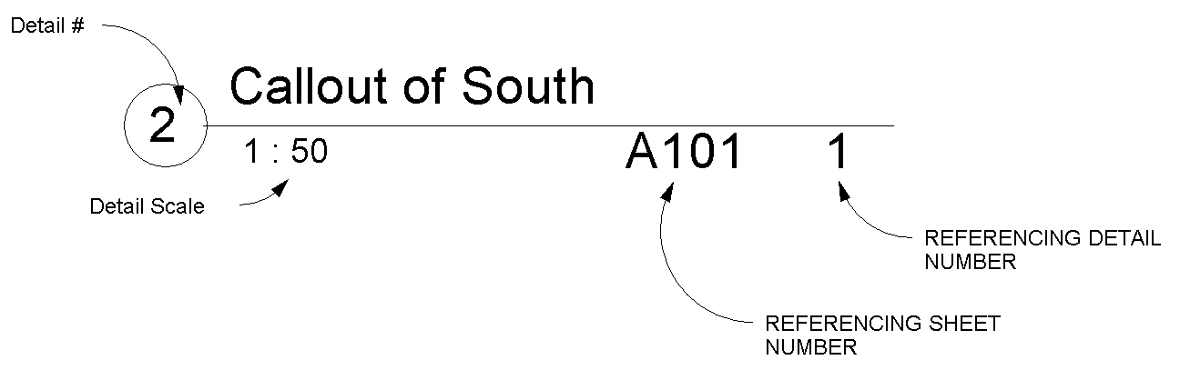

I am wanting to make a (left aligned) view title but have a text lable (with the sheet referenced) aligned to the far right. I can't seem to get the view title line to show up to somehow attach/link the text label to. Any ideas?

I was able to do this by editing the ViewTitle annotation family and adding in two more 'labels' for referencing detail and referencing view.
Attached is the tag in action. Make sure all views and referencing views are placed on sheets or the field is left empty and turns to a blue ? when selected.
