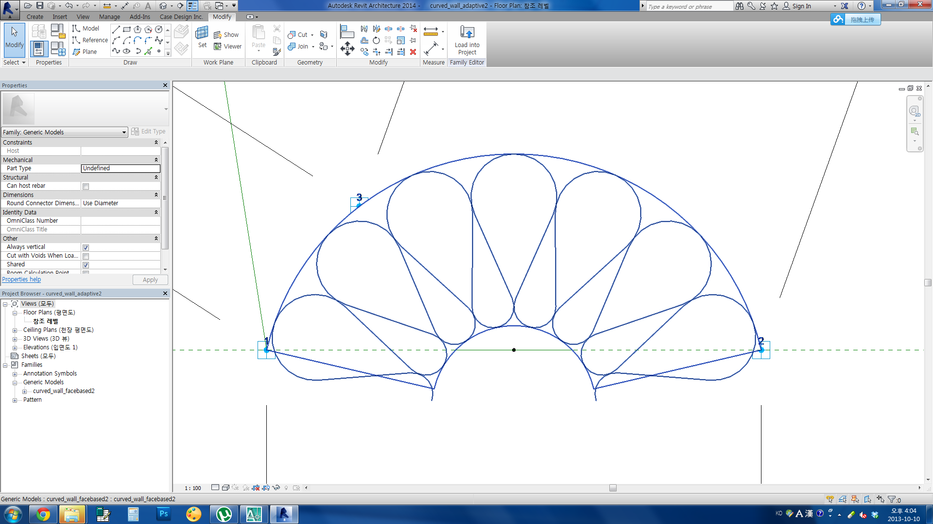

Hi there! I know there is a way to create line based families, but instead of a line is it possible to create them based on an arc? The thought came to me when I was fiddling around with some insulation detail component which is created by specifying only it's radius. And then it creates this circle of insulation. But it is a complere circle and it is not possible to split it, so what if I only want an arc of the insulation? If anyone has any tips and tricks on how to solve this, please throw them in. I've attached the family I have so you're welcome to try and tweak it.

I've made a family which based arch, with 3-points circle.
http://plevit1.blogspot.kr/2013/08/3-points-circle-3-points-arch.html
hope this helps.

I wrote about this issue at my blog.
http://plevit1.blogspot.kr/2013/10/curved-insulation.html
and don't miss the file attached there.
Enjoy. :-)
