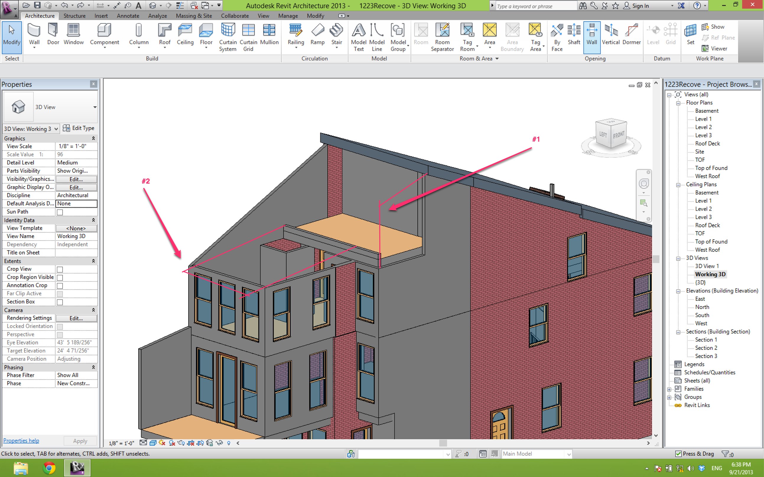

So I'm wandering if anyone can give a hand here. I've got two items I can't quite figure out. See the picture for what I'm trying to accomplish:
#1. I need here a wall (a screen wall I'll call it) that has the same slope as the other portion of the same wall that is connected to the roof. Slope on this roof is 5/12. I thought of splitting the wall, but then I can't figure out how to determine the break point in floorplan view.
#2. I need here a simple shed roof. The slope is determined by the two points it's resting on: West wall (with windows) and the rooftop deck. Haven't really taken a stab at this too much yet, wanted to see if anybody had proper methods.
Any help that can be provided is greatly appreciated. Thanks all!
Mon, Sep 23, 2013 at 8:09:18 AM | Screen wall and a small roof (Rvt 2013)
#1 Just edit the wall profile in elevation.
#2 - I'm sure we know which way is west..... Roofs can be defined by slope or by slope arrows.   Read your help on how.
