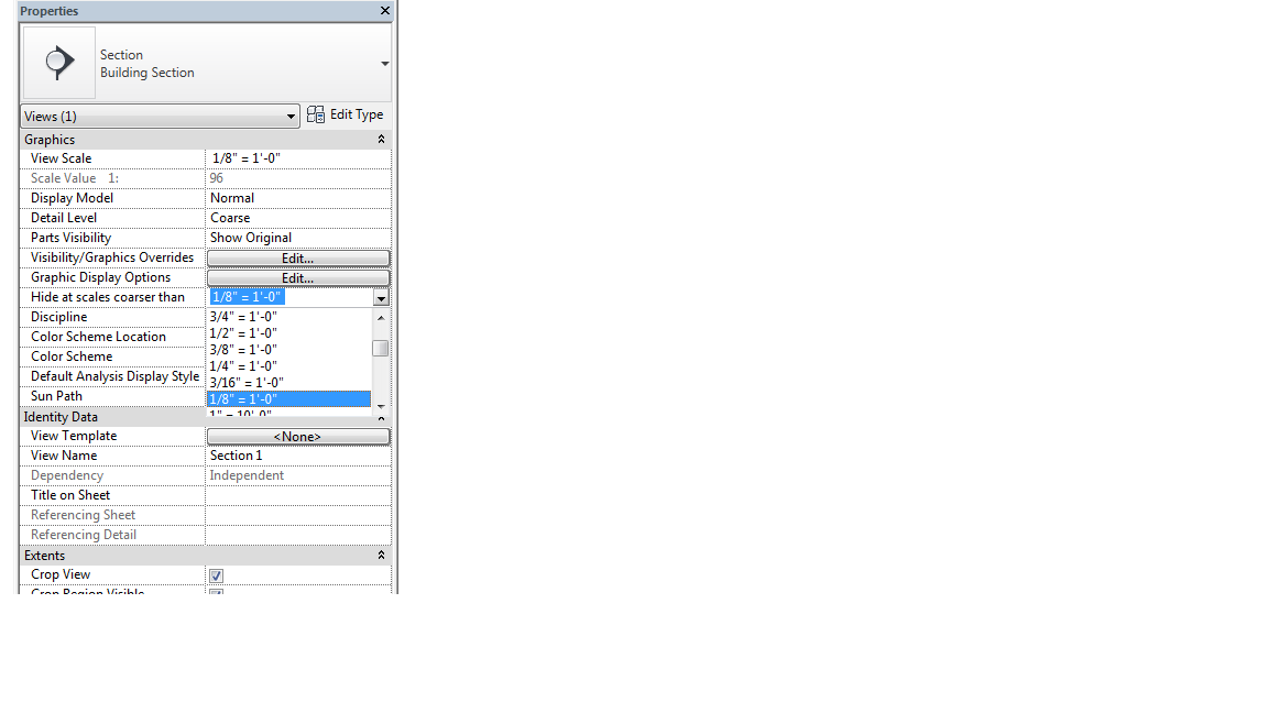

I understand how callouts and creating the "SIM" view works. My question is my project manager wants to get rid of the callouts on reference plans and only have them on the elarged area plans, but all the callouts original reference is on the reference plan. Is there a way you can delete them without deleting the "SIM" view and not losing all the annotation, or do I just have to filter them out. (Just a slight pet peeve of mine to continue to hide / filter itmes, just would rather delete them.)
Thanks
Thu, Sep 12, 2013 at 10:41:57 AM | Callouts and Callout Sim Views
Johnzo142
Joined: Fri, May 8, 2009
47 Posts
You could set your original callout properties to 'hide at scales coarser than'.
