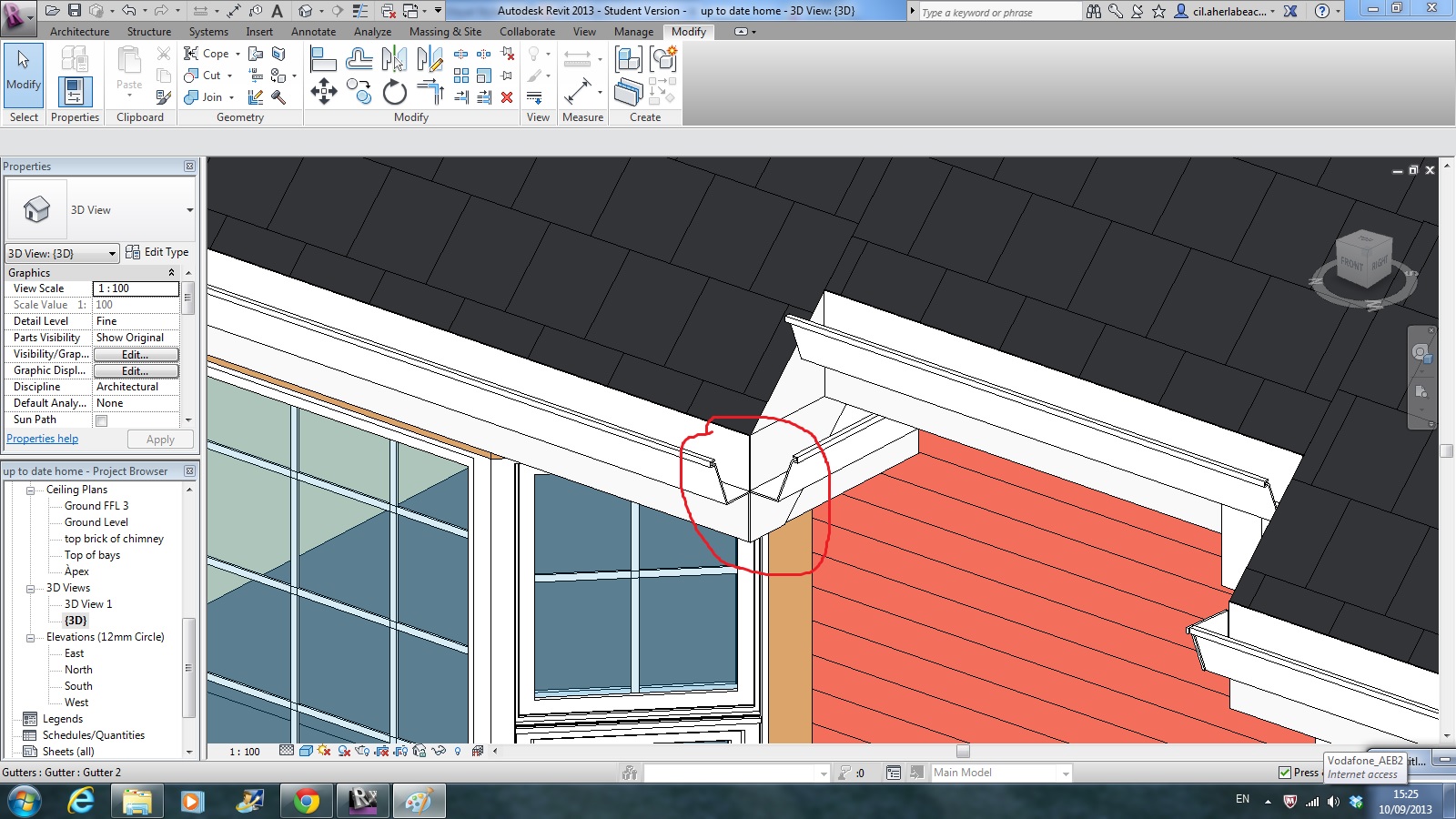

Hi, I have a problem connecting two edges of two seperate gutters around a square corner. pictures attached
Tue, Sep 10, 2013 at 9:41:56 AM | connecting gutters
Gutters will only connect when they are done as one operation or by editing and adding to one that was already placed.  If you are using roof edge, then it will not work here.
