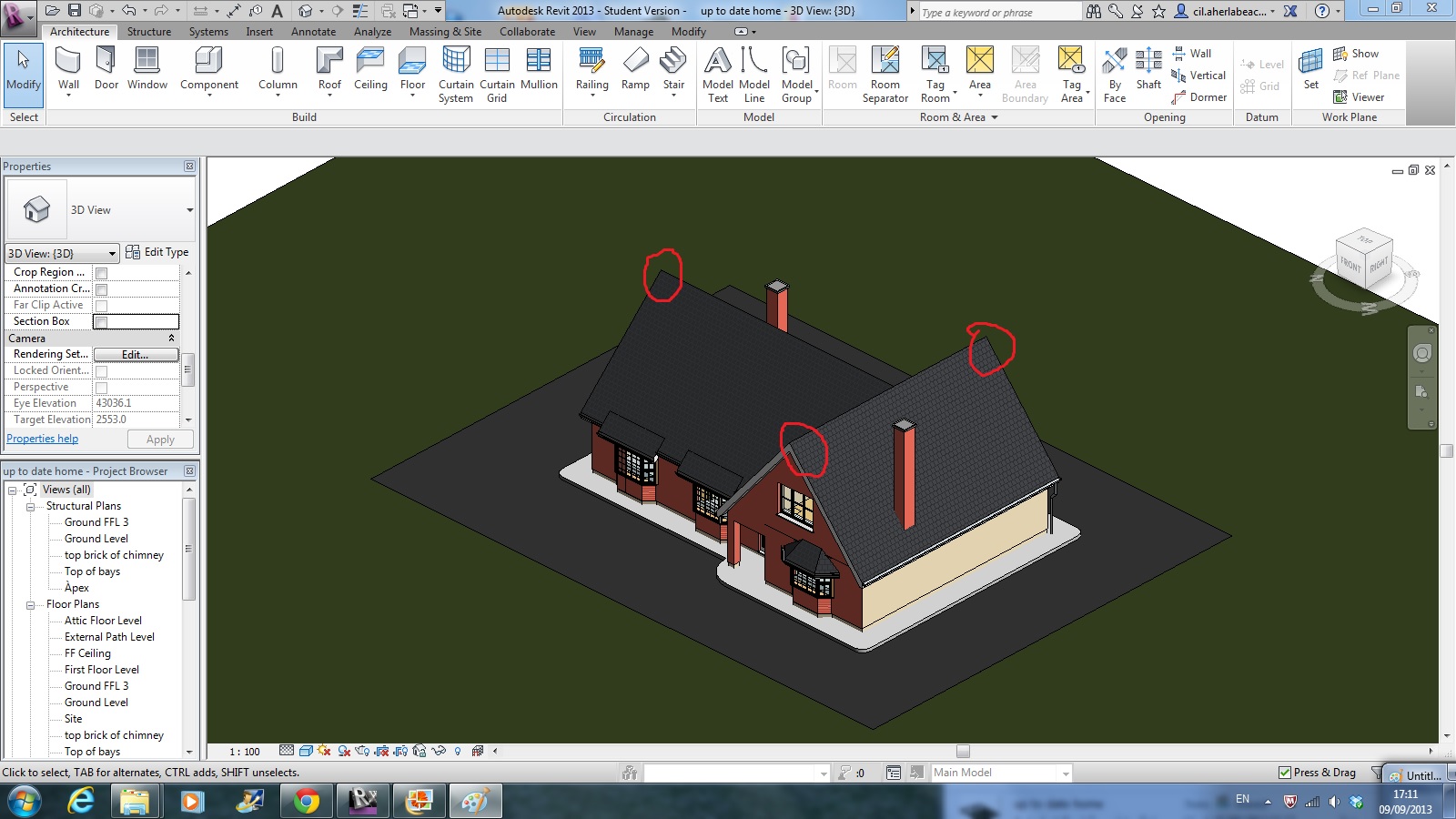

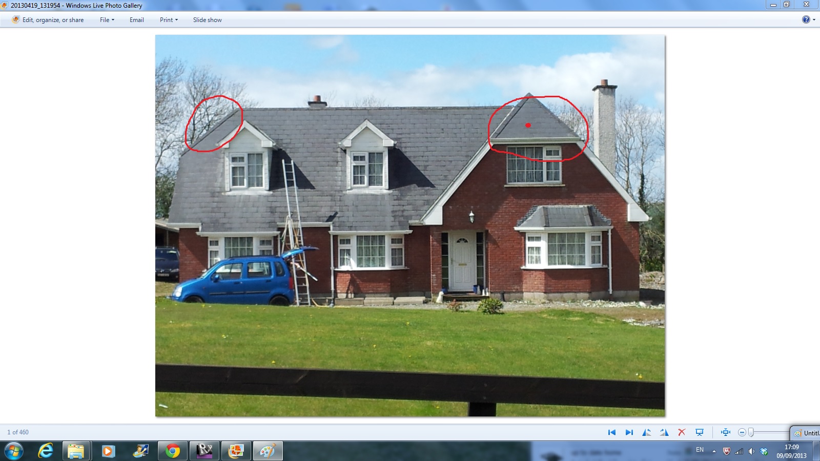

Hi, I have a problem with two seperate roofs on each end I need a hip. the problem is the hip side needs to have a different height gutter/fascia. pictures are attached for help, thanks!

This is a dutch hip. Sketch your roof and select the roof edge line in your sketch that you want to be your hip and under properties change the Offset from Roof Base to the elevation you want your hip to start at.

It worked all I need to do now is get it as close to the original house I'm modelling. many thanks teafoe5!!
