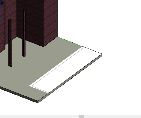

i think decals will do this. INSERT/LINK/PLACE DECAL on the floor
i also think that your attached image has been post processed using photoshop

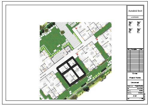

Place a image in Floor plan view. Then create a desired 3D model.
Place both on a sheet and overlap one on other. Hope this helps.
